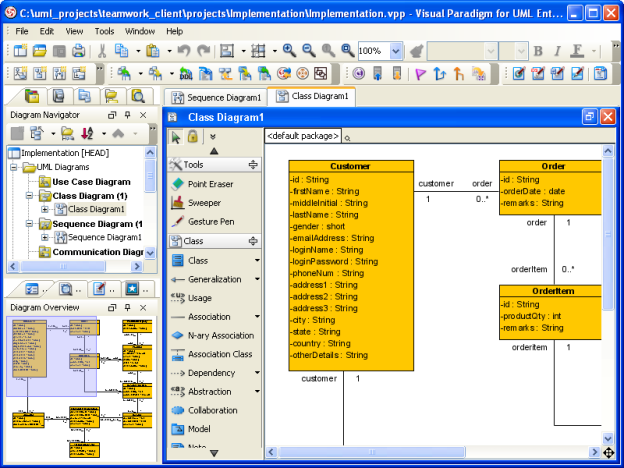

Importing a project into the Repository
Animated Demo

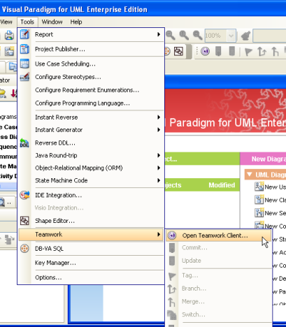

To start modeling collaboratively, you need to use Teamwork Client to import the project to the CVS Repository. Open the Teamwork Client via Tools> Teamwork> Open Teamwork Client...

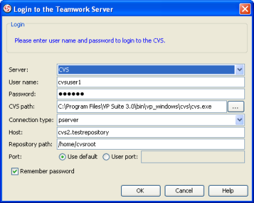

The login dialog box will appear. Select 'CVS' from the drop-down menu, fill in the login details and click OK.

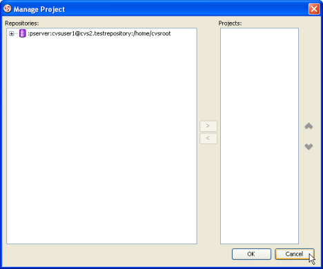

The 'Manage Project' dialog box will appear. As we are creating a new project we do not need to select a repository. Click Cancel to proceed.

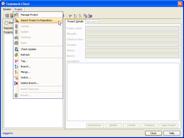

Import a project to the repository by selecting Project> Import Project to Repository

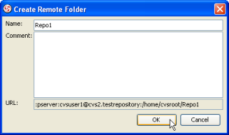

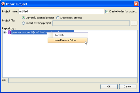

The import project box will appear. Create a remote folder by right-clicking and select 'New Remote Folder'.
Enter the name and a comment for the folder and click OK.

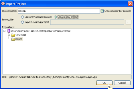

Select a folder for containing the new project. Enter the name of the project and select 'Create New Project'. It is also possible to use a currently opened project as the source or import it from an external project. When you have checked your settings, click OK.

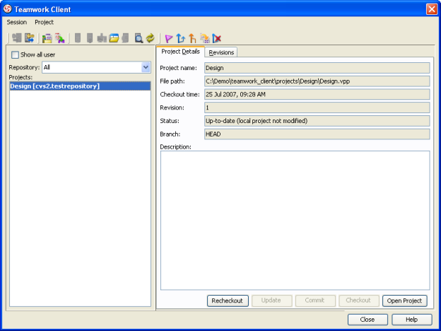

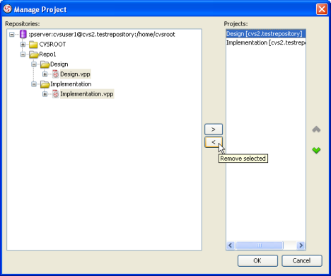

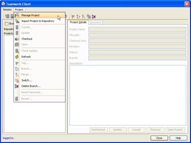

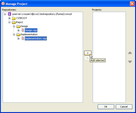

First connect to the CVS repository (see steps above). Then open the 'Manage Projects' dialog box using Project> Manage Project
To manage a project select a project node and click the '>' button to add it to the projects list.
To discard a managing project just select it and click the '<' button to remove it from the list.
When you are satisfied with your list click OK to confirm.

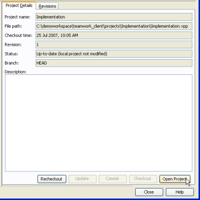

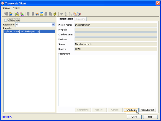

Checking out a project from the repository means to copy the project from the repository into your local drive. Select a project to check out and click the 'Checkout' button in the bottom right corner.

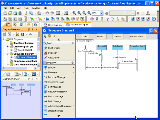

The project is now checked out into your local drive. You can open it in VP-UML by click 'Open Project'. Clicking 'Open Project' without checking out will automatically check out the project before opening it.

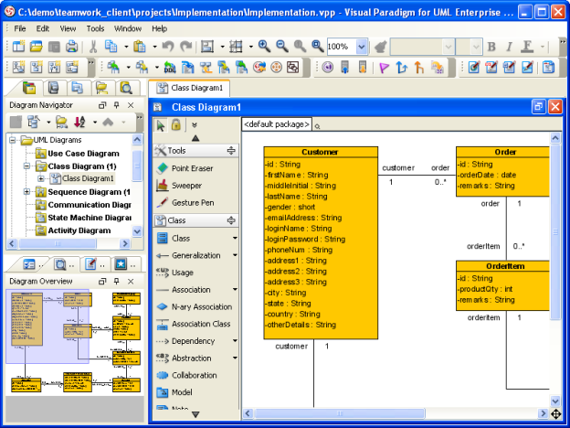

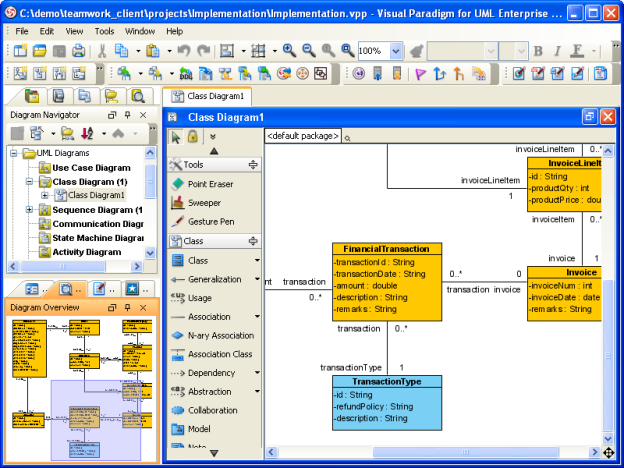

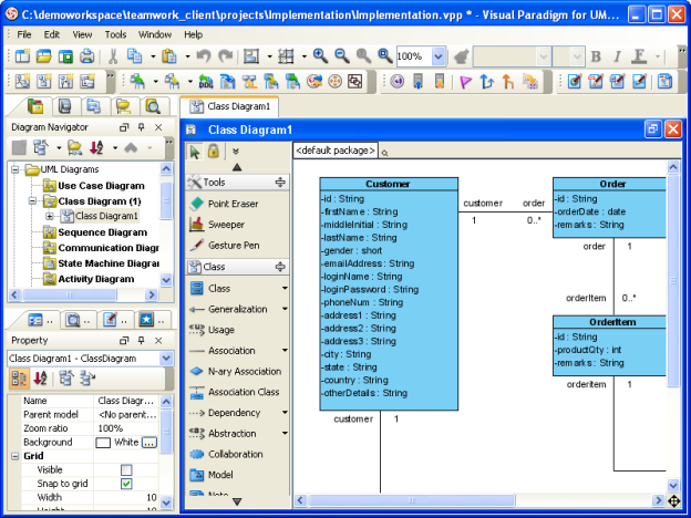

Let's have a look at our modified project.

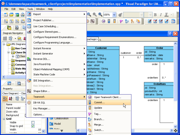

To commit it to the repository select Tools> Teamwork> Commit....
Committing can also be done by clicking the 'Commit' icon in the toolbar or right-clicking a project node in a tree and selecting Teamwork> Commit from the pop-up menu.

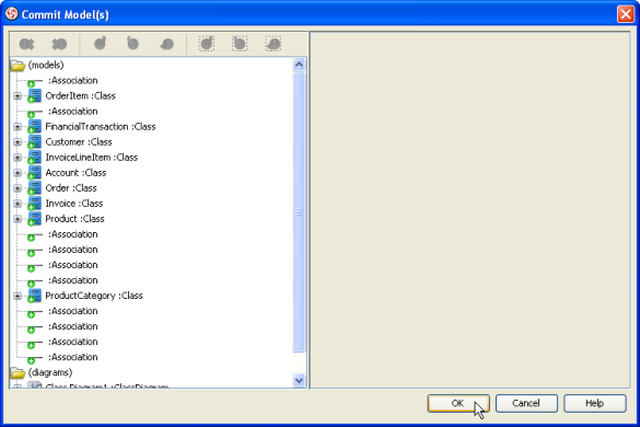

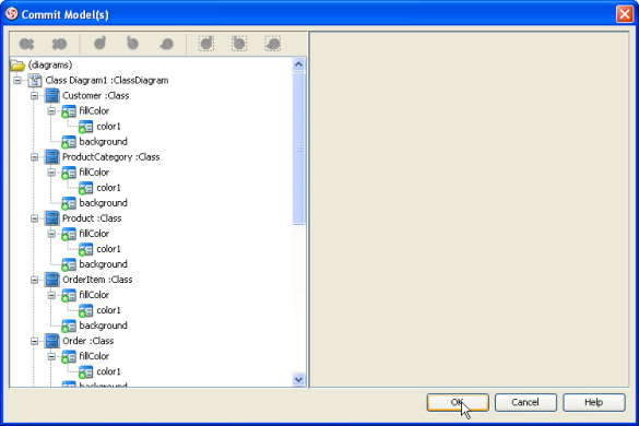

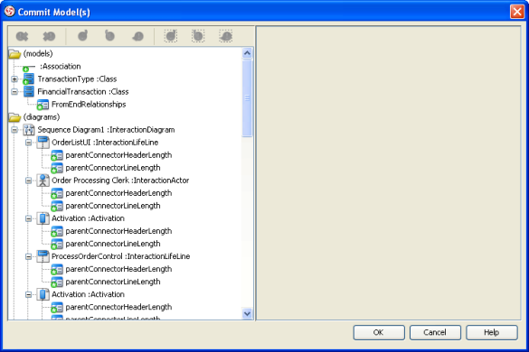

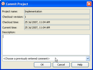

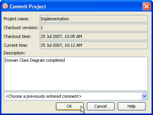

Enter a comment for the project commit and press OK.
The 'Commit Model(s)' box list of modifications that will be committed to the server. Click OK to proceed committing.

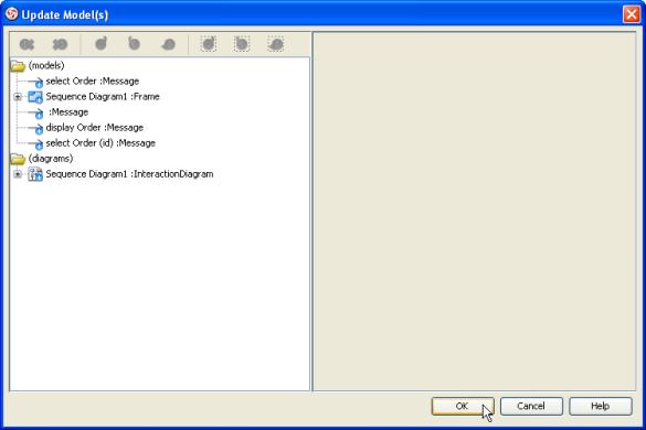

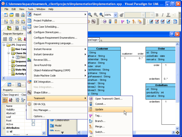

To update changes from the repository select Tools> Teamwork> Update.
The 'Update Model(s)' dialog box lists all the changes that will updated to your project. Click OK to proceed.
The changes made by other team members will be brought to your copy.

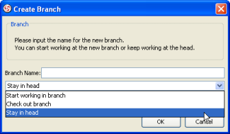

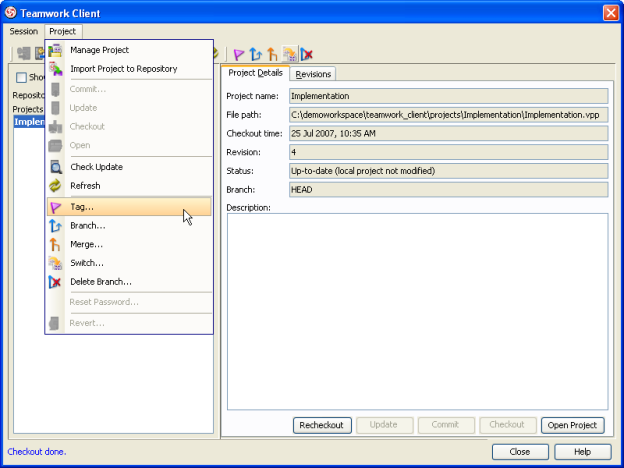

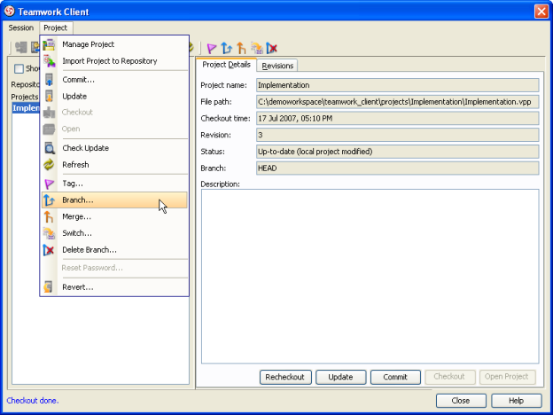

To create a branch or tag first connect to the CVS repository (please refer to section above). Select a project from the Projects list where you want to create a branch and click Projects> Branch from the menu.

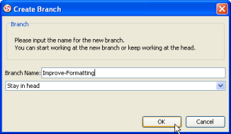

Enter the branch name and select the action you want to take after creating the branch. By selecting "Stay in head", it will stay at the head. Selecting "Start working in branch", it will checkout and switch to the branch, while "Check out branch" will download the branch to the local drive, but stay at the current head. We will select "Stay in head".
Click OK to continue. The branch is now created.

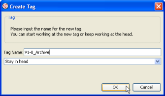

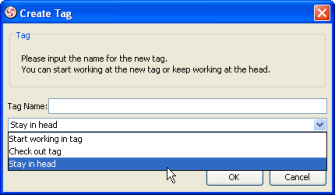

To create a tag for a project connect to the CVS repository and select the project you want to add a tag to from the Projects list. Select Projects> Tag from the menu.
Enter a tag name and select the action you want to take after creating the tag. As with the branches, selecting "Stay in head", will stay at the head. Selecting "Start working in tag", it will checkout and switch to the tag, while "Check out tag" will download the tag to the local drive, but stay at the current head. We will select "Stay in head".
The tag is now created.

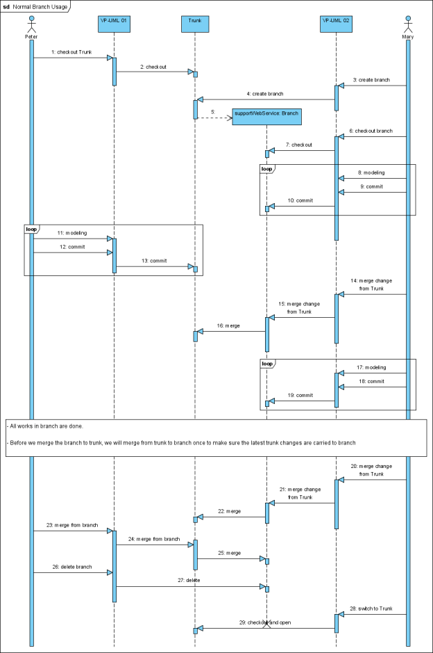

Suggested Branch Usage
Here is an example of how branches might be used in CVS.

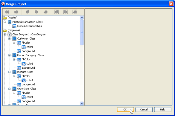

From time to time the head of the project may keep modifying, for instance, to fix modeling issues. You can bring the changes from the head into a branch by using the Merge function. This is the branch project. The color of its classes has been modified to orange.

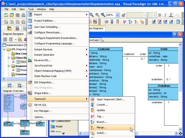

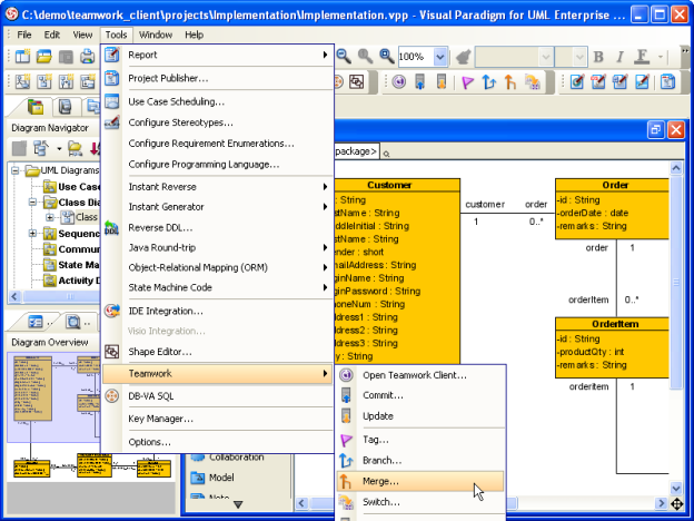

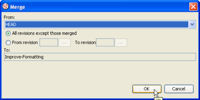

To merge to the branch select Tools> Teamwork> Merge... and a dialog box will show.
Enter the path you want to merge from. By default this path is set to the head. Press OK.
The 'Merge Project' box will show the changes that will be merged to the branch. Click OK to continue.

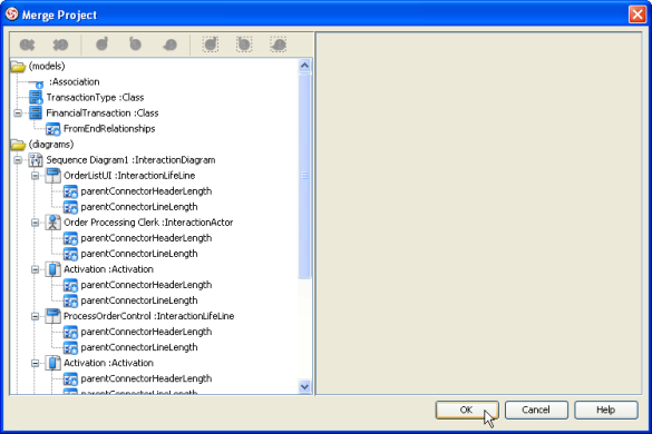

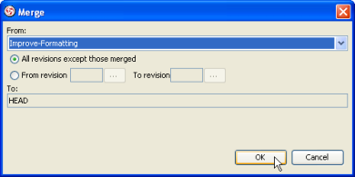

Let's merge the 'Improve-Formatting' branch back to the head. Select Tools> Teamwork> Merge...
From the Merge dialog box, select the branch to merge from, and click OK.
The 'Merge Project' dialog box will show all the changes that will be merged back into the head. Click OK.

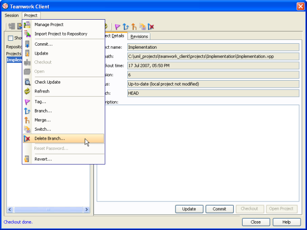

Deleting a Branch

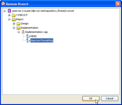

To delete a branch, open the Teamwork Client and select Project> Delete Branch... from the menu.
From the Remove Branch dialog box, select the .vpp file of the branch to be removed and click Select.
Enter a comment in the dialog box and click OK to delete the branch.
