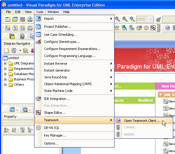

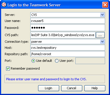

1. Select Tools > Teamwork > Open Teamwork Client... from the main menu.

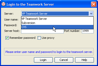

This shows the Login to the Teamwork Server dialog box.
2. Select CVS as Server
This expands the dialog box to show additional fields for connecting to the CVS server.
3. Fill in all the fields to connect to the CVS Server. You may need to contact the repository administrator for assistance in filling in the information.
Field Description
User name The name of user under which to connect
Password Password for the user
CVS Path The path of the cvs.exe file (The default is pointed to the cvs.exe inside $vp-suite-install-dir/bin/vp_windows/cvs)
Connection type The type of CVS connection for the repository (The default is pserver)
Host The address of the host
Repository path The path of the repository at the host address

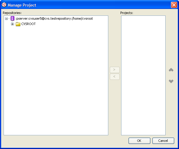

4. Press the Login button to connect to the server. This shows the Manage Project dialog box, which is for selecting a project file to work with.

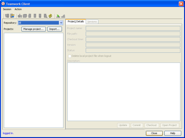

5. Press OK to skip this dialog box. This shows the Teamwork Client dialog box.

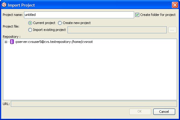

6. Press Import... This shows the Import Project dialog box.
7. Enter the project name of which to import.
8. Specify the source of the project to import to the CVS server.
Option Description
Currently opened project The project that is opened in the running application
Create new project A blank and new Visual Paradigm project
Import existing project An external project file

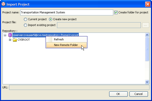

9. To create a remote folder to store the project in server, right-click on a tree node and select New Remote Folder from the pop-up menu.
If Create folder for project is checked, this will create a remote folder, which have the same name as the project file, for storing the project file.
10. Click OK when done.
Checkout a Project
By importing a project to the server, clients can check that out from the CVS server to the local machine.
1. Select Tools ;> Teamwork ;> Open Teamwork Client... from the main menu to open the Teamwork Client project dialog box.
2. Select the project to check out with.
3. Press Checkout to proceed with checking out the project.
Notice that by checking out a project you get a copy of the teamwork project. In order to work with the project, you need to open it in the application. To open a teamwork project, simply click Open Project, which is next to the Checkout button from the Teamwork Client dialog box.

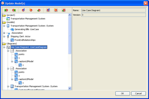

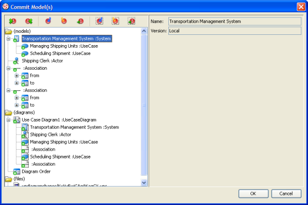

This shows the Commit Model(s) dialog box, which list the changes that will be made to the server copy of the project.
A conflict might be found if someone else's committed change(s) cause conflict with the change(s) you made. You must resolve all the conflicts to proceed with committing the project. There are two ways of resolving a conflict, Overwrite and Revert. By Overwriting, the server version will be overwritten by the local version for that particular change. By Reverting, the server version will be selected.
