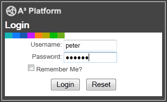

  1. Login as Peter.
    login

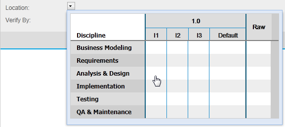

  6. This is a design Task. Select its Location: 1.0 > I1 > Analysis & Design

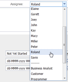

  7. Select Roland to be the Assignee, who is responsible for designing the register screen.
    select assignee

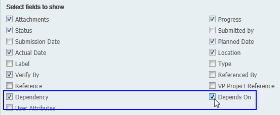

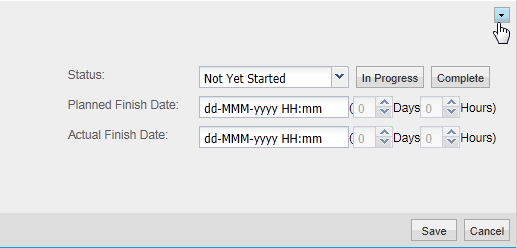

    Here we are going to make use of the dependency feature to create the next task that will be initiated after completion of the screen design Task. Before we move on to creating another Task, we need to enable the related fields first. Click on the tiny button on the right hand side below the Details box, with an inverted triangle in it.
    add fields
  9. Check the checkboxes to show the Dependency and Depends On fields. Click OK at bottom right to confirm.
    show dep fields

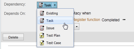

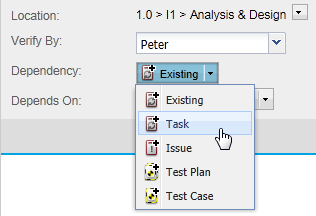

  10. The fields Dependency and Depends On are now displayed. The Dependency field determines which Task is pending to be initiated and triggered by the completion/start/close of this Task. Contrary to Dependency, the Depends On field specifies which Task is being relied on by this Task for trigger. We will use the Dependency field only in this tutorial and we will talk in detail later on. Now, we want to create a Task for implementing the register function. Click on the inverted triangle button next to the Dependency field and select Task from the drop down menu.
    dependency

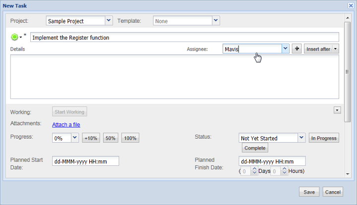

  11. This opens a new form for creating a new Task that is dependent on the screen design Task. Enter the name of the Task: Implement the Register function
  12. The name is descriptive enough. Let's omit the details. Select Mavis to be the Assignee. She will be responsible for implementing the register function.
    new dep act
  13. Click Save to return to the screen of designing Task.

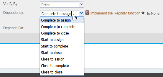

  14. The Dependency field is updated to show the newly created Task. Click on the drop down menu and select Complete to assign. A list of available options is displayed.
    depend opts
    The options are used to set rules to determine under what condition the dependent Task will be assigned/completed/closed. Here is a description of the available options:
    Option Description
    Complete to assign When the Status of this Task is set to Completed, assign the dependent Task.
    Complete to complete When the Status of this Task is set to Completed, set the dependent Task to Completed.
    Complete to close When the Status of this Task is set to Completed, set the dependent Task to Closed.
    Start to assign When the Progress of this Task is set to be between 0% to 100%, assign the dependent Task.
    Start to complete When the Progress of this Task is set to be between 0% to 100%, set the dependent Task to Completed.
    Start to close When the Progress of this Task is set to be between 0% to 100%, set the dependent Task to Closed.
    Close to assign When the Status of this Task is set to Closed, assign the dependent Task.
    Close to complete When the Status of this Task is set to Closed, set the dependent Task to Task.
    Close to close When the Status of this Task is set to Closed, set the dependent Task to Closed.
  15. The default selection for Depends On is Complete to assign, which is fitting in this case, so let's keep it.

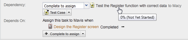

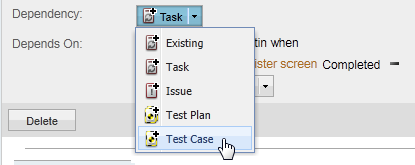

  19. Create a dependent Test Case. This time, click on the inverted triangle at the Dependency field and select Test Case from the drop down menu.
    create test case

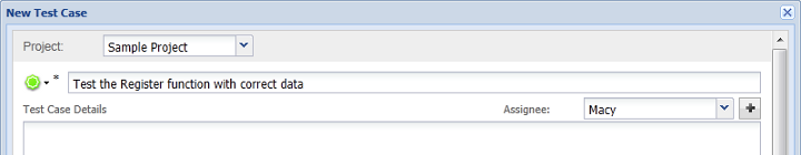

  20. In the popup window, enter the name of the test case: Test the Register function with correct data
  21. Macy, a tester, is responsible for testing. Select Macy to be the Assignee.
    enter test case name assignee

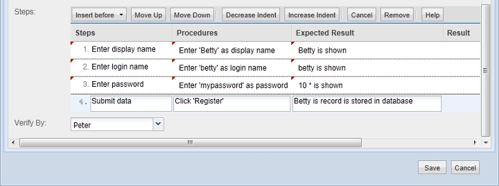

  22. Scroll down the window and enter the steps of testing the register function. We are not going to talk about testing here. If you want to know more about planning and performing testing, please read the tutorial Plan and Perform Testing.
    steps entered

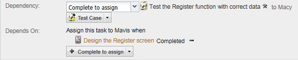

  23. Click Save to return to the implementation Task.
  24. Same as before, we shall assign the test case to Macy when the function is implemented. Keep the relationship of dependency be Complete to assign. Click Save at bottom right.
    dependency updated

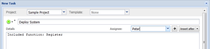

  28. Enter the name of the Task: Deploy System
  29. Enter the details: Included function: Register
  30. Set Peter to be the Assignee.
    new task
  31. Click Save to return to the Test Case.
