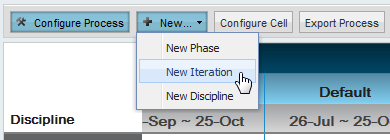

  8. Let's create an Iteration. Click New next to the Configure Process button. Select New Iteration from the drop down menu.
    new iteration

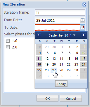

  9. In the popup window, enter the name of Iteration: I4.
    name iter
  10. Set the Iteration period of the Iteration by entering the From Date and To Date.
    set to date
  11. Decide the Phase that the Iteration should be covered. Select the Phase(s) needed. Note that you must select at least one Phase. Select 1.0 and 2.0. Click OK to confirm.
    select phases

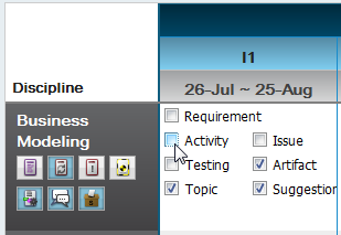

  2. Look for the cell 1.0 > I1 > Business Modeling. Uncheck Activity to make its progress not to be reported in this cell.
    uncheck act

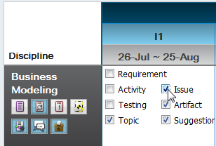

  3. Show the progress of Issue in cell by checking it.
    check issue
  4. Click Configure Cell again to confirm the changes.
    click configure cell
