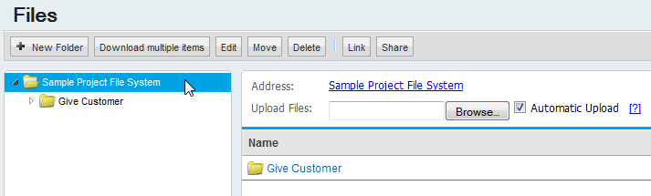

  3. Let's create a folder. Click on the root folder Sample Project File System in the list on the left hand side.
    select root folder

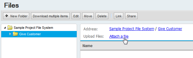

  6. Click on the link Attach a file.
    attach file

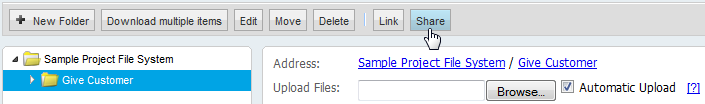

  8. Let's grant the customer permission to download the file. Select the uploaded file.
    file selected
  9. Click Share.
    share

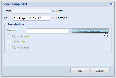

  10. In the Share window, you may set the from date, which is the date when the sharing begins, and the to date, which is the date when the sharing stops. To avoid the file being downloaded by any anonymous user, you may set a password. Click Generate Password to generate a random password.
    gen pwd
  11. Click OK.

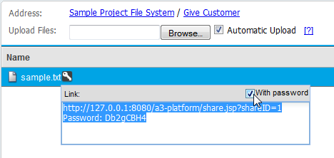

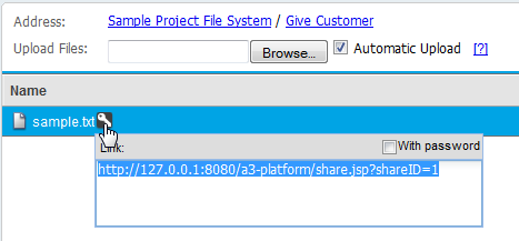

  12. Next to the shared file, there should be an icon. Click on it.
    share file
  13. Click the checkbox With password to show the password.
    with password
  14. Now, you can copy the hyperlink and send it to the customer. Press Ctrl-C to perform copying. The content in the text box will be copied.

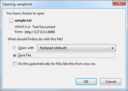

  18. The shared file is listed in the page. Click on its name to download it. If there are multiple files for the customer to download, click on Download multiple items to proceed with downloading.
    download file
  19. Save and open the file.
    download and open file

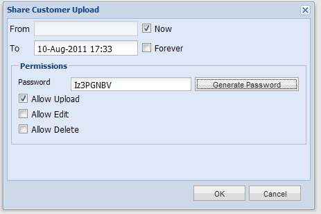

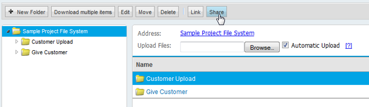

  5. On the right hand side, the folders under the root folder are listed. We want to allow customer upload files to the Customer Upload folder. Select it, and click Share.
    click share
  6. In the Share window, make sure the option Allow Upload is checked (default: checked). Click Generate Password. Click OK.
    share window

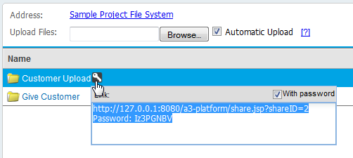

  7. Click on the icon next to the folder name. Copy the URL and password.
    copy url and password
  8. Open a text editor (e.g. Notepad) and paste the copied text.

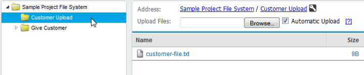

  13. Go back to the original Web browser. Open the folder Customer Upload. The file uploaded by the customer should be listed.
    file selected
  14. To download it, just click on it.
