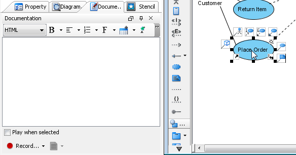

  1. Let's try to create voice documentation for the Place Order use case. Select the Place Order use case and switch to Documentation pane.
    select element
  2. Press the Record button in the Documentation pane, a Record Voice dialog will be shown.

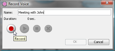

  3. Name the voice as Meeting with John, then press the Record button to start recording.
    record
  4. Once you finish record the voice, you can press the Stop button to end the recording. The Play button allows you to playback the recorded voice directly. You can also press the Cancel button to discard the voice and record it again. Press OK to confirm the recorded voice.

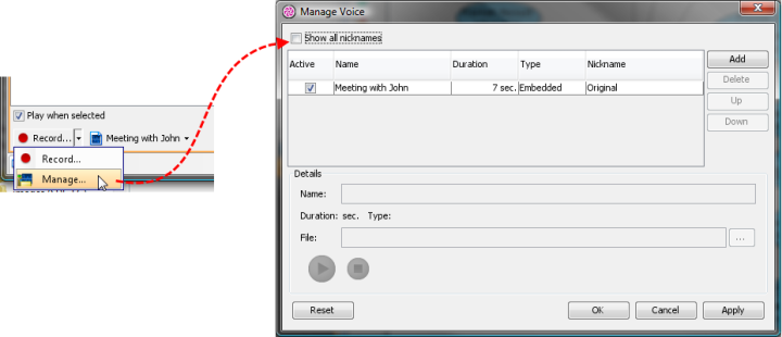

  9. Besides recording voice from Agilian, you can also attach existing voice file (.wav) to the model. Press the Manage button in the Documentation pane to open Manage Voice dialog.
    manage

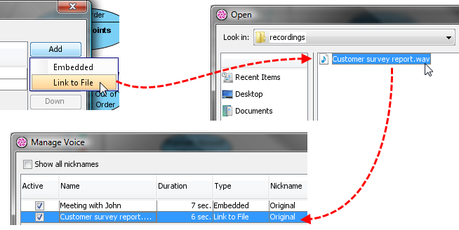

  10. Press the Add button, and then select the voice file from your file system.
    add voice
  11. By default the Manage Voice dialog will show the voice for the current working nickname. You can select Show all nicknames to display all voice attached to the model, no matter it is under which nickname.
    show all nickname
  12. You can play specific voice by selecting it and press the Play button at the bottom of the dialog.
    play

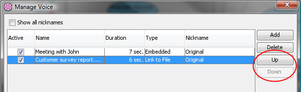

  13. You can also reorder the voice using the Up and Down buttons.
    sory
