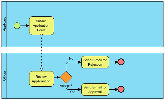

  1. Assume you have drawn the following business process diagram:

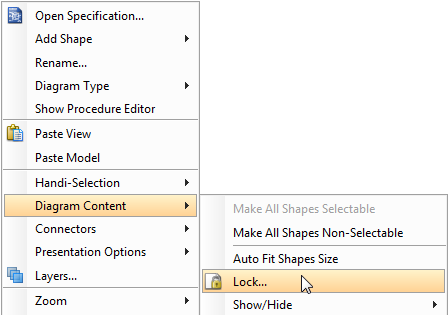

  2. To avoid it being modified by other team members, you can lock the diagram before committing. Right clicking on the diagram's background and select Diagram Content > Lock... from the pop-up menu.

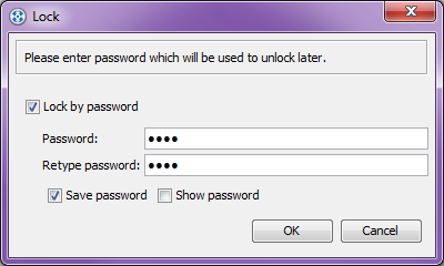

  3. Enter your password in the pop-up Lock dialog box and then click OK button.

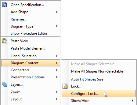

  6. You can unlock the diagram after you set the password. Right click on the diagram's background and select Diagram Content > Configure Lock... from the pop-up menu.

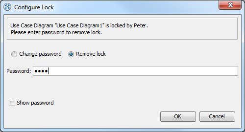

  7. In Configure Lock dialog box, choose Remove lock. Enter the password you set previously and click OK button to confirm.
