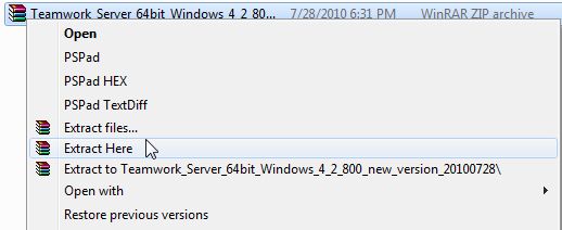

  1. After you have downloaded VP Teamwork Server zip file, right click on it and select Extract Here from the pop-up menu to extract it.
    extract zip

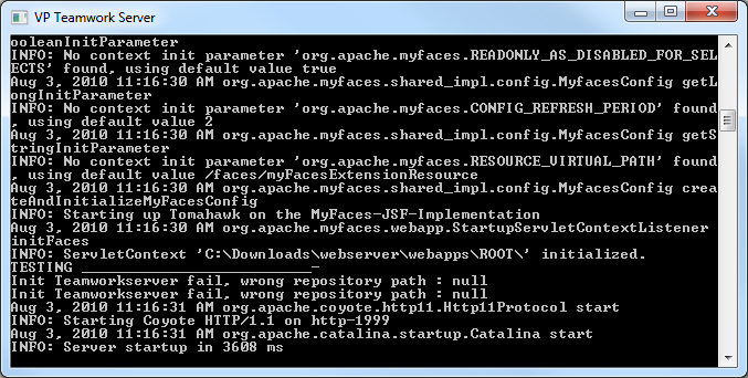

  3. Subsequently, the VP Teamwork Server dialog box pops out. It indicates that VP Teamwork Server is turned on.
    vpts startup

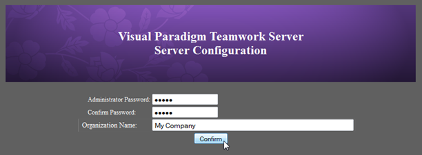

  5. You can see the Server Configuration main page. Enter administrator's password and confirm the password by typing the password again. Enter organization name as My Company and then click Confirm button.
    enter pin

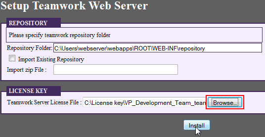

  6. In the Setup Teamwork Web Server page, click Browse... button under LICENSE KEY section to select the location of your license key and import it. Click Install button.

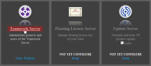

  7. Click Teamwork Server to click in the administration page.
    enter ts

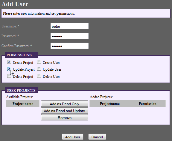

  9. Enter peter as username, password and confirm password. Moreover, you can customize the task(s) the user is allowed to perform in the project. Check Create Project and Update Project under PERMISSIONS section.
    usename

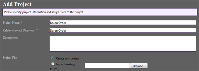

  14. In the Add Project page, enter project name as Sales Order.

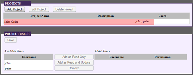

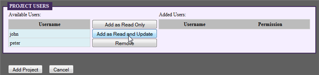

  15. Next, you can assign available users to perform the project. Select john and peter and then click Add as Read and Update button.
    select users
  16. Click Add Project button.
  17. Finally, Sales Order project is created with john and peter assigned to the project.
    project users created
