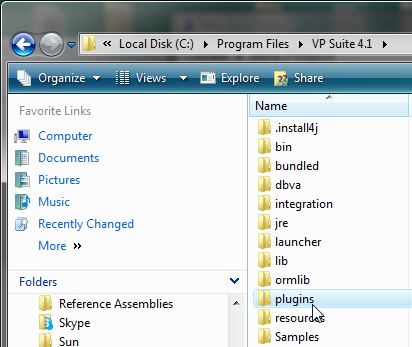

  1. Create plugins folder under VP Suite installation directory, and deploy your plug-in to the plugins folder (include source files).
    new plugins folder

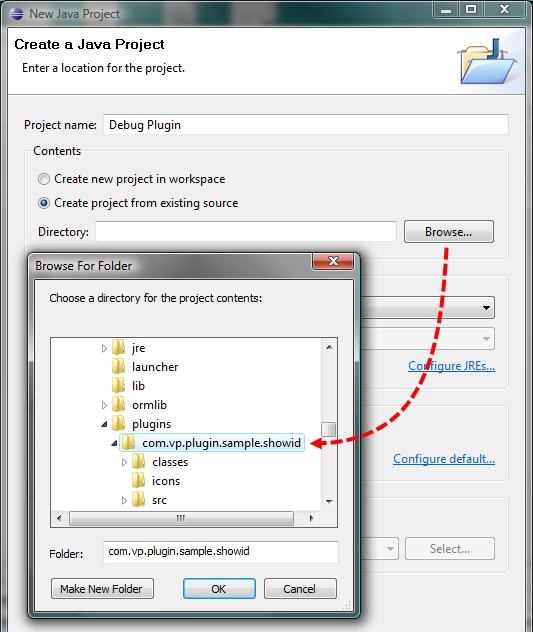

  2. Create eclipse product from existing source by pointing to your plug-in inside VP Suite/plugins folder, Press Next to proceed.
    project location

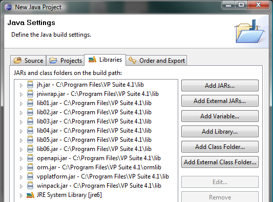

  3. Include all the following jar files under to project Libraries.
    Filename Parent Directory
    vpplatform.jar VP Suite/lib
    jniwarp.jar
    jh.jar
    winpack.jar
    openapi.jar
    lib01.jar - lib06.jar
    orm.jar VP Suite/ormlib
    library

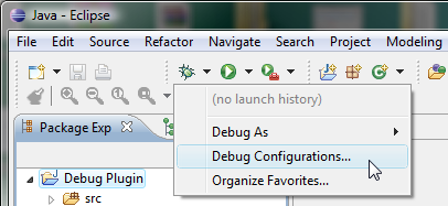

  4. Select new Debug Configuration.
    debug config

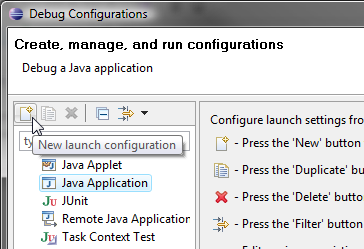

  5. Select Java Application, and then press the New launch configuration button.
    new launch config

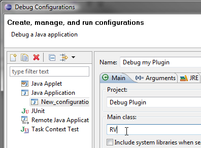

  6. Name the configuration as Debug my Plugin, and specify the main class as RV.
    specify main class

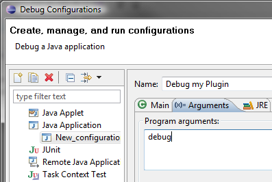

  7. Switch to Arguments tab, and enter debug in Program arguments.
    debug para

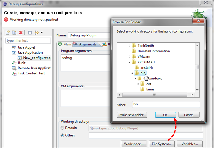

  8. In the Working directory field, select File System..., and then specify VP Suite/bin folder.
    working dir

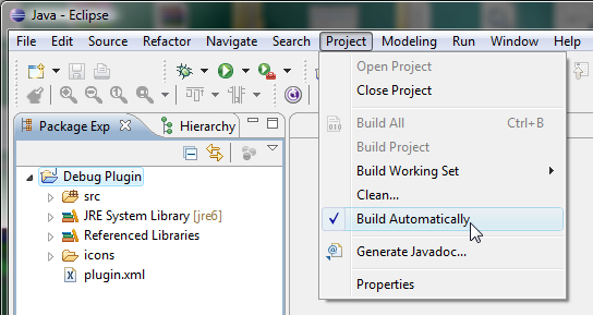

  9. Press Apply to commit. After that you can press the Debug button to start debugging your plug-in. You can change the source of your plug-in directly in eclipse. Changes will reflect directly in VP after you save your modification (note that you have to specify the Build Automatically under the Project menu).
    auto build
