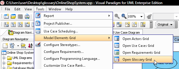

  1. Select Tools > Model Elements Grid > Open Glossary Grid.
    open glossary grid

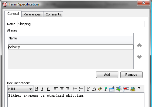

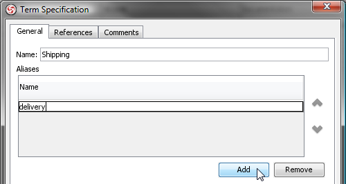

  5. You can define alias for this term. Press the Add button below Alias box to create new alias. Name the alias as delivery.
    new alias
  6. You can also define documentation for the term. Let's enter Either express or standard shipping. In the Documentation area. Press OK to commit.
    define doc

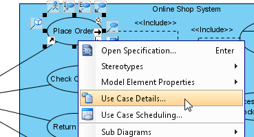

  8. Switch to Revised Use Case Diagram, right click on the Place Order use case and select Use Case Details.
    open use case details

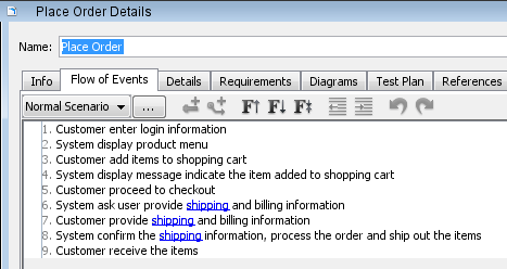

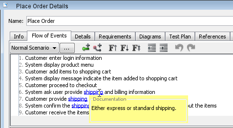

  9. Switch to Flow of Events tab. Now the words shipping are being highlighted.
    highlighted
  10. Place the mouse pointer over any of the highlighted words, documentation will be shown up.
    show doc

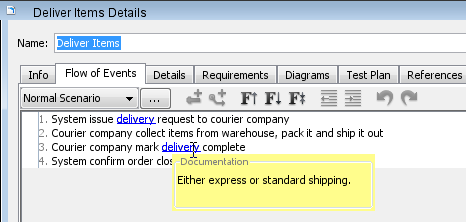

  11. Open the use case detail for the Deliver Item use case, the word delivery is also being highlighted, since it is the alias of the term Shipping as defined in glossary.
    showing alias

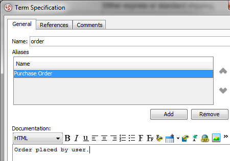

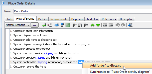

  12. Besides using Glossary Grid, you can also add new terms from use case detail editor. Select the word order, right click and select Add "order" to Glossary.
    add term from ucd
  13. And define alias and documentation for term order.
    add new glossary
  14. Now go back to the use case detail editor, and you can see the word order is being highlighted. Again, place the mouse pointer over the word order and you can see its documentation.
    highlight

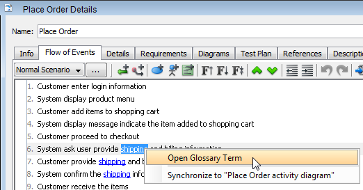

  15. You can navigate from the highlighted words to Glossary Grid by right click on it, and select Open Glossary Term.
    open glossary term

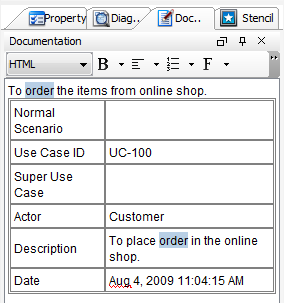

  16. The glossary terms you defined will also be highlighted in the documentation of model elements.
    highlight doc

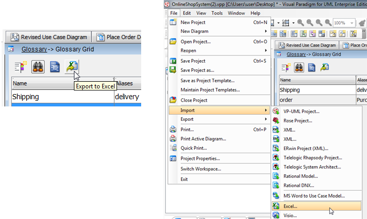

  17. You can export the glossary, along with its terms into an Excel file, and import it back to aid in a mass modification or review.
    export to excel
