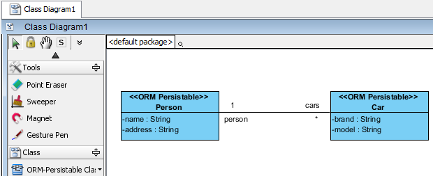

  1. We first have to define our data model. Let's define our data model using class diagram. Make sure the ORM Persistable stereotype has been specified for the entity classes.
    class model

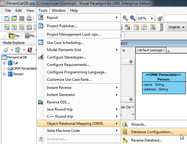

  2. Select Tools > Object-Relational Mapping (ORM) > Configure Database to open the Database Configuration dialog.
    config db menu

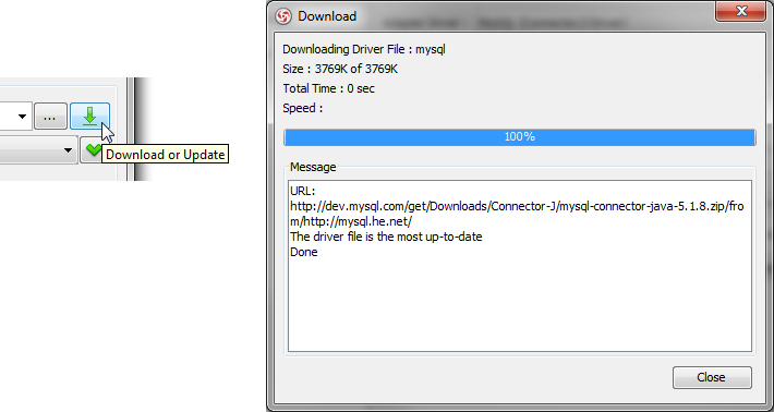

  4. Press the green down arrow button in the Adapter File field to let VP-UML download the adapter file for you. You may need to configure proxy server if you need it for accessing Internal.
    download driver

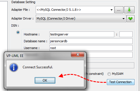

  5. Specify the database connection details inside the DSN section, and then press the Test Connection button to see is the connection configured properly.
    test connection

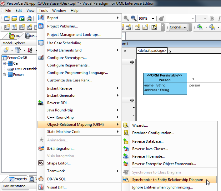

  6. Select Tools > Object-Relational Mapping (ORM) > Synchronize to Entity Relationship Diagram.
    sync to erd

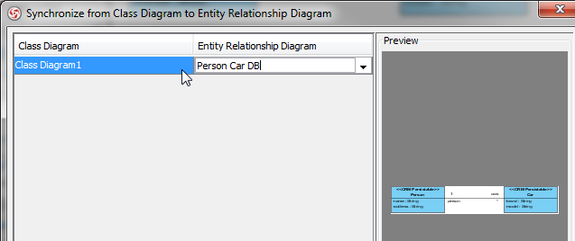

  7. The Synchronization from Class Diagram to Entity Relationship Diagram dialog will be shown. You can synchronize multiple class diagram at once. The name of the target ERD can be specified directly in the dialog. You can also preview the original class diagram by clicking on the name of class diagram.
    sync

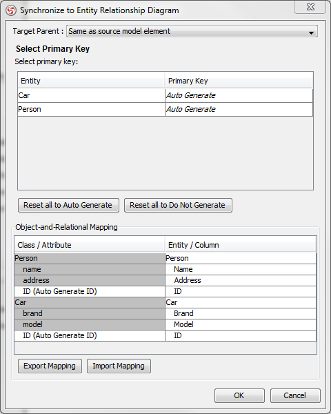

  8. By pressing OK, the Synchronize to Entity Relationship Diagram dialog will be shown. You can specify the Primary Key column, also the name of the mapping entity also the columns directly in this dialog.
    sync name

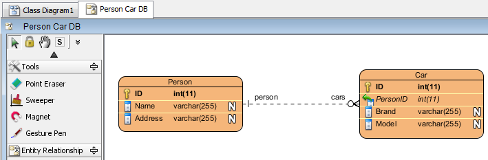

  9. Now the Entity Relationship Diagram for your class model is being generated.
    erd

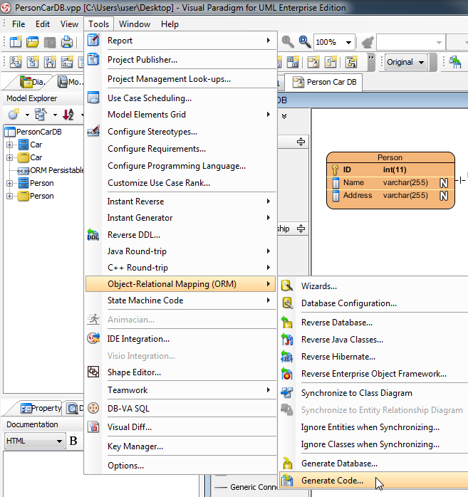

  10. Select Tools > Object-Relationship Mapping (ORM) > Generate Code to open the Database Code Generation dialog.
    gen code

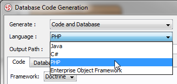

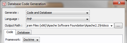

  11. In the Database Code Generation dialog, make sure you have selected generate Code and Database, also generate code for PHP.
    select lang
  12. Specify the document root of your apache server in the Output Path field, and select Doctrine in Framework combo box.
    output path

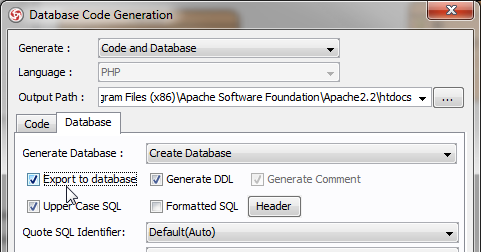

  13. Switch to Database tab, and select Export to database. This will help you to create the schema directly in your database.
    export to db

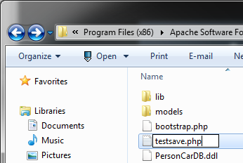

  15. Create a blank file under document root, name it as testsave.php.
    new page

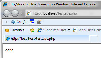

  22. Open the browser and go to testsave.php, the word done should be echo in the page.
    browser save

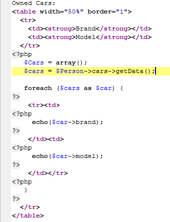

  26. Once we loaded the person objects, we can access the associated car objects through the cars collection.
    load cars

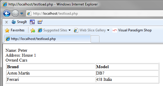

  27. Open the testload.php in browser; the person objects and his associated car will be shown.
    load result
