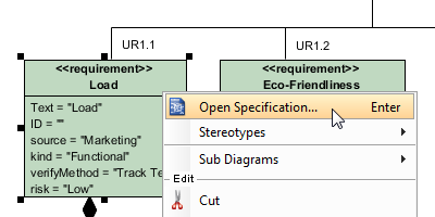

  1. Open specification dialog of requirement Load.
    open spec

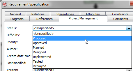

  2. Switch to Project Management tab.
    proj mang prop dialog
  3. Specify value for each of the project management properties. Set Status to be Proposed, Difficulty to be Medium, Version to be 1.0 and Author to be Peter.
    project management tab

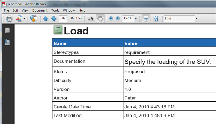

  4. Generate a PDF report. The properties you have specified are output in report. Note that this works for HTML and Word report, too.
    gen report

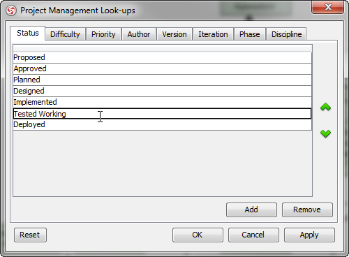

The values for each property can be customized to fit for your needs. To configure the values for each property:

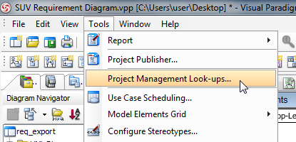

  1. Select Tools > Project Management Look-ups.
    open lookup

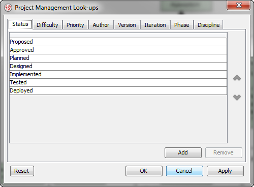

  2. The Project Management Look-ups dialog will be shown.
    lookup dialog

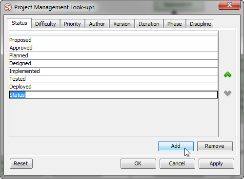

  3. Add a new property by clicking Add. Then remove it by pressing Remove.
    new var
  4. Modify existing property Tested to Tested Working.
    modify var

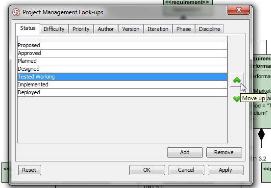

  5. Keep Tested Working selected and click Move up.
    move
