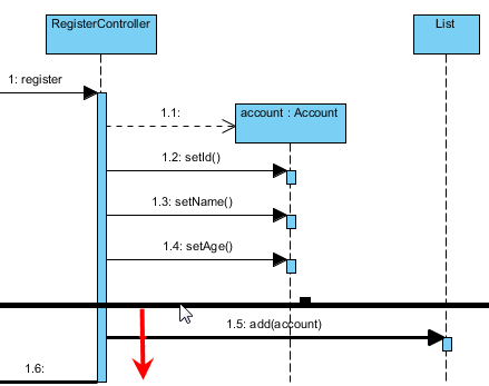

Extending space with sweeper
  1. Select Sweeper from the diagram toolbar.
    sweeper
  2. Move the mouse over the diagram pane where you want to extend space.
  3. Hold onto your mouse and move the line horizontally or vertically to extend more space.
    extend space
