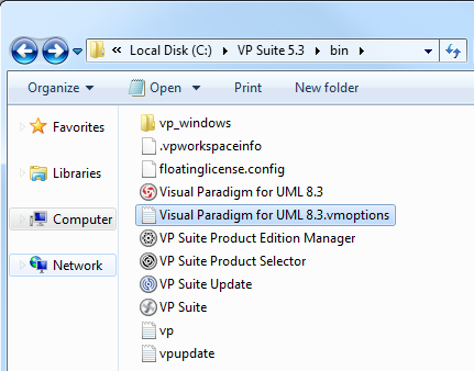

  3. Create a blank new file with extension .vmoptions and the file name MUST be the same as that of the executable. For example, name it Visual Paradigm for UML 8.3.vmoptions if you are going to run Visual Paradigm for UML 8.3.
    new file in bin

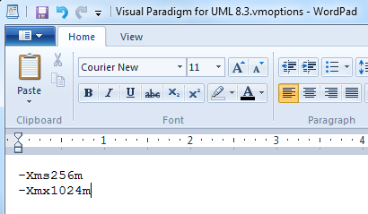

  4. Open the file in a text editor (e.g. WordPad) and add the following:
    -Xms256m
    -Xmx1024m
    edit bin text file
  5. Save the file.

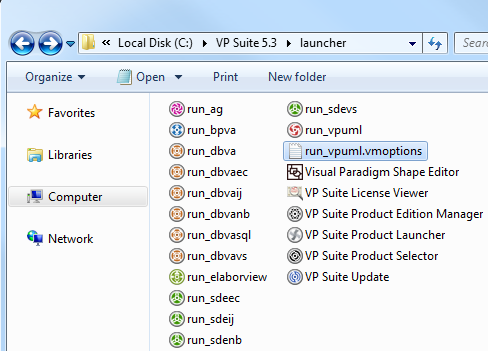

  6. Go to the /launcher folder under VP Suite or the /bin folder under the BP-VA installation directory.
  7. Create a blank new file with extension .vmoptions and the file name MUST be the same as that of the launcher of the executable. For example, name it run_vpuml.vmoptions if you are going to run Visual Paradigm for UML 8.3.
    new file in launcher

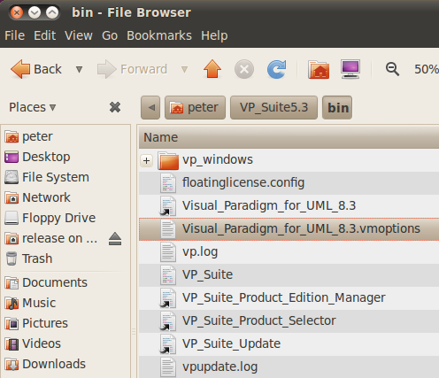

  2. Go to the /bin folder of VP Suite/ BP-VA installation directory.
  3. Create a new blank file with extension .vmoptions and the file name MUST be the same as that of the executable. For example, name it Visual Paradigm for UML 8.3.vmoptions if you are going to run Visual Paradigm for UML 8.3.
    linux created vmoptions in bin

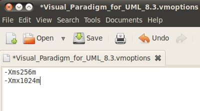

    -Xms256m
    -Xmx1024m
    edit vpoptions in bin

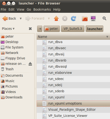

  6. Go to the /launcher folder of VP Suite/ BP-VA installation directory.
  7. Create a new blank file with extension .vmoptions. Note that the name of the file MUST be the same as that of the launcher of the executable. For example, name it run_vpuml.vmoptions if you are going to run Visual Paradigm for UML.
    linux created vmoptions in launcher

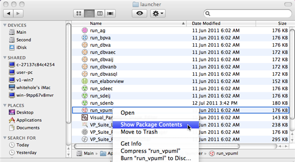

  3. Right click on the executable and select Show Package Contents from the popup menu. The name of the executable is "run_" + the product's short name, i.e. for VP-UML, the executable is run_vpuml. And for BP-VA, the executable will be run_bpva.
    show package content

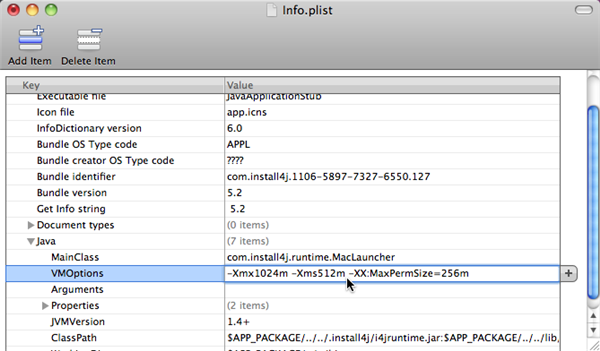

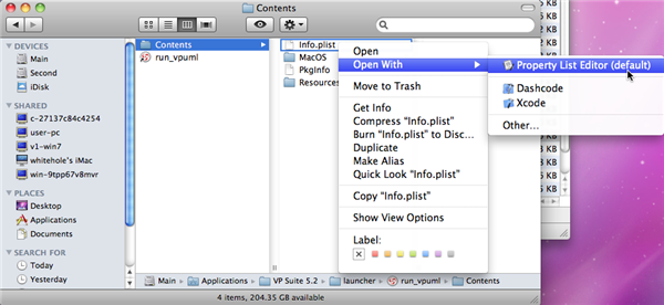

  4. Go to the Contents folder. Right click on the Info.plist and select Open With > Property List Editor.
    open property editor
  5. Expand the Java key and edit the VMOptions property as shown below.
    edit property
  6. Save your changesand close the Property List Editor.
