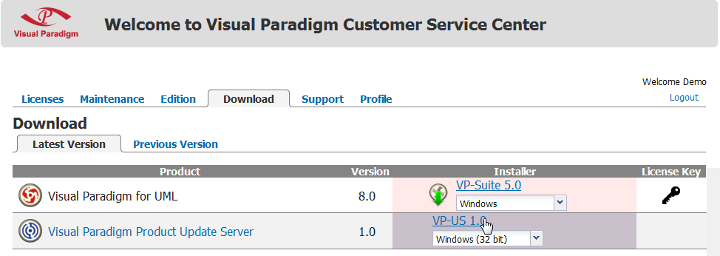

Update server is available to Visual Paradigm customers. Customers can login to their customer account and download the server program from the Download page.
  1. Login to Visual Paradigm Customer Service Center at:
    https://cs.visual-paradigm.com
  2. Visit the Download page.
  3. Select the operating system of update server installer to download and click on the installer link.
    download server
    If you cannot find the update server option, download Teamwork Server/Floating License Server instead. They both include the update server.

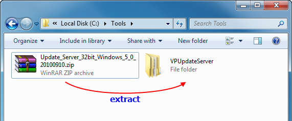

  1. Extract the downloaded update server to somewhere in your machine.
    extract

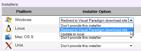

  7. In the Installers section, specify the source of installer files per operating system. Select Redirect to Visual Paradigm download site.
    installer option
    Here are the available options:
    • Don't provide this installer - User will not see the download button when visiting the main page of update program. In other words, download is disabled for the installer of this operating system.
    • Redirect to Visual Paradigm download site - When client click the download button, it will try to download the installer from Visual Paradigm's download site through the internet.
    • Update to local - Installer files will be downloaded from the Internet to the update server from time to time. When client click the download button, it will try to download the installer from update server.

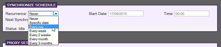

  8. Configure how often updates will be checked and downloaded in the Synchronize Schedule section. The dropdown menu Recurrence controls how often updates will be checked. By selecting an option other than Never, set the start date and time, which is the first time to start checking and downloading product updates. Select Every day here.
    sync schedule

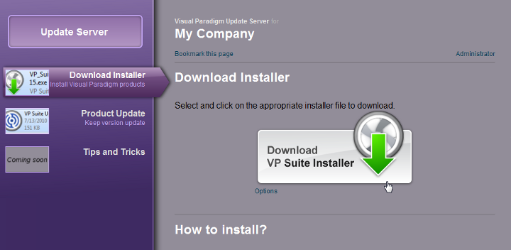

  1. Open the web browser and visit http://%UPDATE_SERVER_IP%:8080/ (e.g. http://192.168.0.100:8080)
  2. Click on the Download VP Suite Installer button and proceed with downloading.

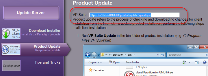

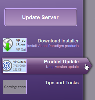

  1. After the installation, visit the Product Update page of update server.
    product update
  2. Copy the VP Suite update URL on the right hand side of the page.
    copy url

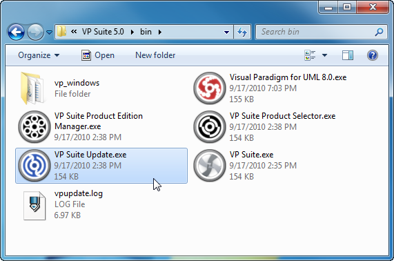

  3. Run %VP_SUITE_INSTALLER_DIR%\bin\VP Suite Update.exe.
    run update

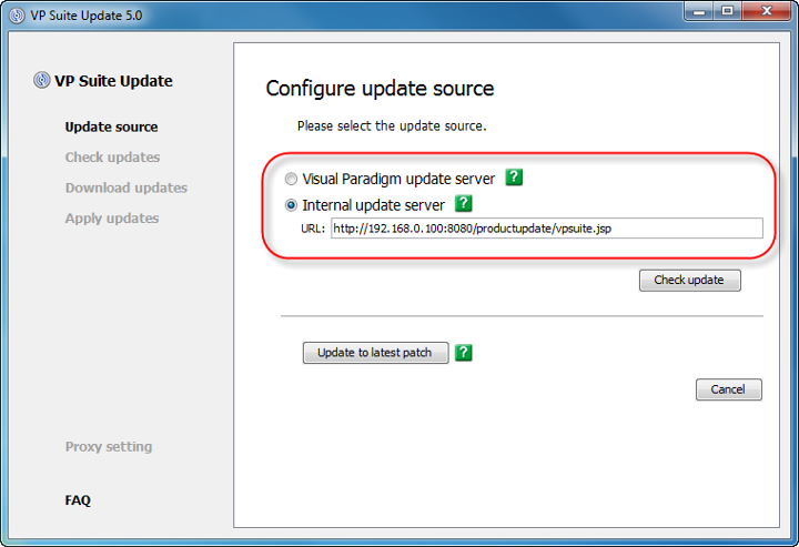

  4. In the VP Suite Update dialog box, select Internal update server and input the copied path to the URL field. Click Check update.
    configure update

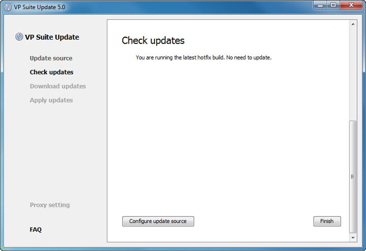

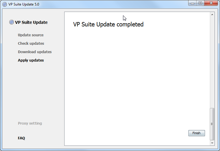

  5. You should see the following screen, telling you that you are already running the latest version. Click Finish. Now, VP Suite "knows" your update source (the path input above). It will help you perform checkig periodically when you run a product (e.g. VP-UML).
    nothing to update

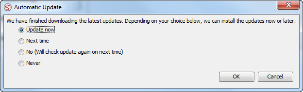

  4. Let's say we want to update the installation now, keep Update now selected and click OK.
    auto update

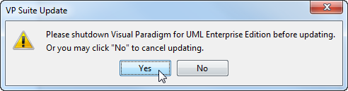

  6. During update, you must shutdown the running products to avoid the updated files crashing with the executing files. Exit the running product and click Yes to continue.

  7. When finished, click Finish to exit from update. When you start the product again, it will be running in latest version.
