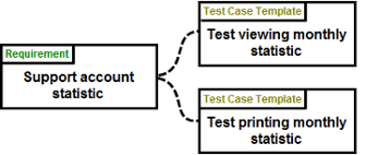

When a Requirement has been supported, you may want to test it to make sure the Requirement has been supported in a way that the user expected. You can make use of the Sub-Test-Case Templates function to define how the Requirement should be tested.
Relationship between Requirement and Sub-Test-Case Template

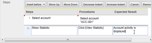

  4. Enter the Name of Test Case.
  5. Enter the Stpes of Test Case.
    Enter the steps of Test Case

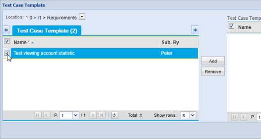

  3. Click Add Existing.
    To add an existing Test Case Template
  4. In the popup window, check the Test Case Template to add to Requirement on the left hand side. Click Add. You can look for a Test Case Template by selecting the Location where the Test Case Template resides.
    Select Test Case Template to add to Requirement
