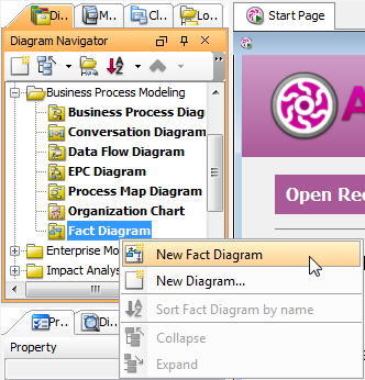

To create a fact diagram, right click on Fact Diagram in Diagram Navigator and select New Fact Diagram from the popup menu.
To create a fact diagram through Diagram Navigator
