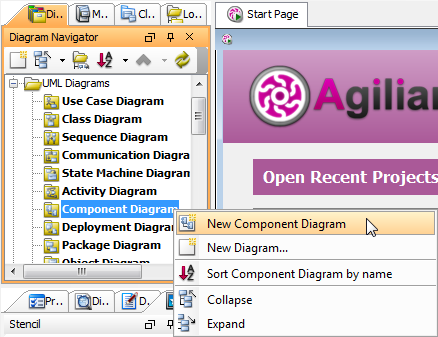

  • Click on UML on toolbar and select Component Diagram from the drop down menu.
  • Right click on Component Diagram in Diagram Navigator and select New Component Diagram from the popup menu.
  • Select File > New Diagram > UML Diagrams > Component Diagram from the main menu.
Create component diagram

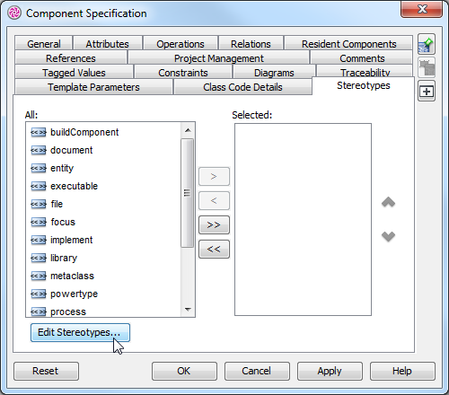

Right click on the package and select Stereotypes > Edit Stereotypes... from the pop-up menu.
Assign stereotypes
Assign stereotypes
When the Component Specification dialog box pops out, the Stereotypes tab is opened by default. The list on the left shows the selectable stereotypes.
If the stereotype you want to use is not on the list, click Edit Stereotypes... button.
Edit stereotypes
Edit stereotypes
