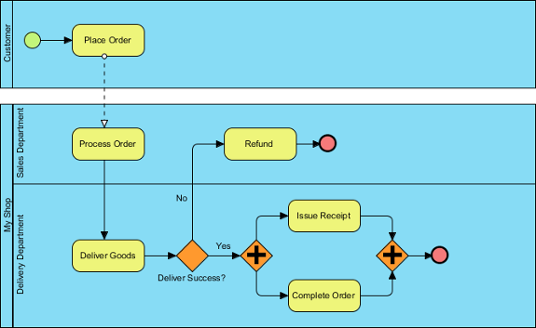

Business Process Modeling Notation (BPMN) is a graphical representation for designing and modeling business processes visually. It is a standard for business process modeling, and provides a graphical notation for specifying business processes in a business process diagram (BPD).
A sample business process diagram

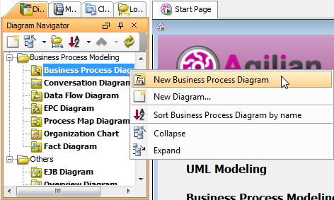

To create a business process diagram, right click on Business Process Diagram in Diagram Navigator and select New Business Process Diagram from the popup menu.
Create a business process diagram through Diagram Navigator

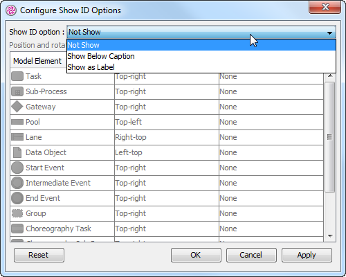

To configure how to show ID (or not to show ID), you can either set the global option (refer to the previous section), or set it through diagram's option by right clicking on the business process diagram, selecting Presentation Options >Configure Show ID Options... from the pop-up menu.
To show ID on a diagram
In the Configure Show ID Options dialog box, click on the drop down menu Show ID Options and select if you want to show IDs, and if yes, where to show - below caption or as a label.

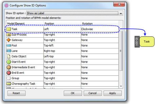

If you selected to show as label, you can adjust in further the position of ID, relative to the shape (e.g. Top right of task) and the rotation.
To make ID of task show as label, position at the left of shape

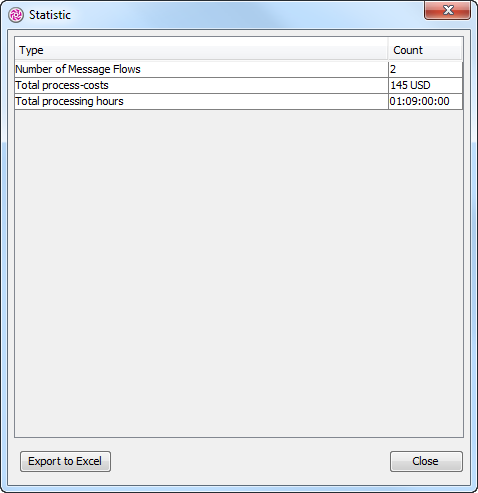

Process statistic refers to the results of the statistical analysis that can be conducted upon your process. There are three types of figures: number of message flows, total process-costs and the total processing hours.
To show process statistic:
  1. Right click on the background of the business process diagram.
  2. Select Utilities > Show Statistic... from the popup menu. This opens the Statistic window, like this:
    Process statistic
    Process statistic
    Below is a description of figures.
    Figure Description
    Number of Message Flows The number of message flows that exist in the current diagram.
    Total process-costs A summation of costs specified for tasks and sub-processes in the current diagram.
    Total processing hours A summation of duration specified for tasks and sub-processes in the current diagram.
    Description of figures in process statistic
