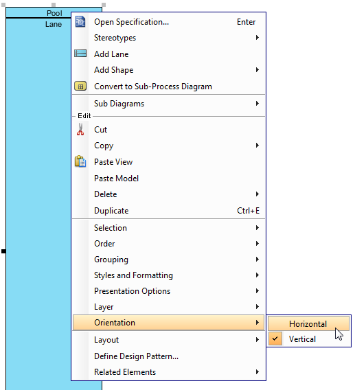

Orientation of pool and lane
In a business process diagram, pool and lane can show either vertically or horizontally. There is no restriction to the orientation of pool. You can choose an orientation that gives the best layout to your design. To change the orientation of pool and contained lane, right click on the pool header and select Orientation > Vertical/Horizontal from the popup menu.

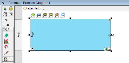

Stretching of pool
When you create a pool, it is automatically expanded to fit the width or length of diagram. We call this behavior stretched. When a pool is stretched, the pool and the contained lane(s) will expand or collapse following the size of diagram, and you cannot resize it manually. If you want to make a pool freely resize-able, you need to turn the stretch behavior off. To change the stretch option, right click on the pool involved and select Presentation Options > Auto Stretch > Off from the popup menu.
Pool can be resized freely when auto-stretch is turned off

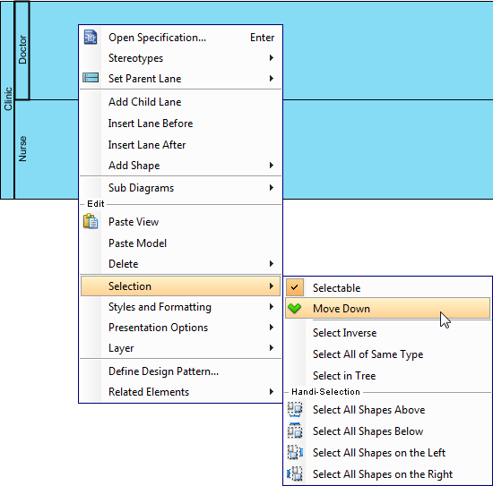

Reordering lane
You can change the position of lanes within a pool by moving them up and down. To reorder a lane, right click on the lane you want to reorder and select Selection > Move Down from the popup menu.
