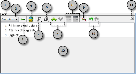

An overview of procedure editor
No. Name Description
1 Collapse/Expand Click on the triangle on the left hand side to maximize the editor. On the contrary, click on the inverted triangle to minimize the editor.
2 Procedure selector You can define multiple set of procedure per activity. Click on this drop down menu to select the one you want to read/edit.
3 Step
Click on this button to create a step under the step selected in editor.
4 Hyperlink... Add a link in the selected step for reference.
5 Font formats selector There are three buttons. The first one increases the font size for one level, while the second one decreases the font size for one level. The third button resets the font size setting to default.
6 Font size setting selector Click on this drop-down menu to select the sizes of highlighted text. Press Grow Font button to increase the font size for one level, while press Shrink Font button to decrease the font size for one level. Press Default Font button reset the font size setting to default. Moreover, you can adjust the font size for the highlighted text manually by slider.
7 Reorder step
Click on Move Up button to move the selected step upward while Move Down button to move the selected step downward.
8 Decrease Indent/ Increase Indent Click on Decrease Indent button to reduce the indentation of the selected step while click on Increase Indent button to indent the selected step.
9 Undo/ Redo Click on Undo button to revert change while click on Redo button to redo reverted change.
10 Close editor
Click on this button to close the editor.
11 Steps editor
The place where you can read and edit steps.
Description of procedure editor
