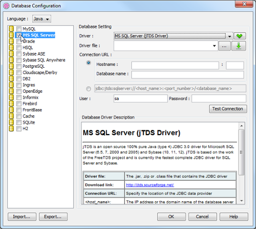

Selecting database
In the Database Configuration dialog box, check the target database.
Select database
Select database
You can select multiple databases, and set one of them as default database. The default database is used for rendering the column type and generating SQL. To set a database as default, right click on the database and select Set as default from the pop-up menu.

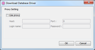

Configure proxy if required, click OK button to continue download.
Download JDBC proxy setting
