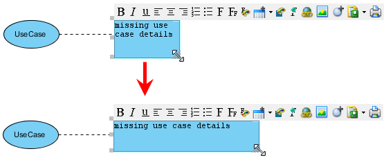

Editing note content
  1. Double click the note to start editing its content. Note that the toolbar above the note can be used to format its content.
    Start editing
    Start editing
  2. Drag the bottom right corner of note to resize it.
    Resize the note
    Resize the note
  3. Click on the diagram background to confirm editing the note.
