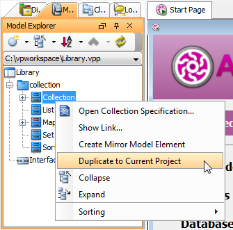

Sometimes, you need the elements created in another project, not to appear as form of references, but to make it become your own data. You will need to duplicate element from linked project. To duplicate a model element:
  1. Open the Model Explorer.
  2. Right click on the element you want to duplicate ands elect Duplicate to Current Project from the pop-up menu.
    Duplicate a model element
    The duplicated element can be found in Model Explorer, under current project.
