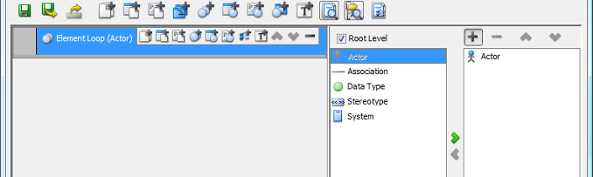

  2. If you have chosen to add a model or a package loop, you do not need to perform any actions in further.
    If you have chosen to add either root level or all level element loop, select the type of element(s) to loop on the right hand side of the template editor and click  to confirm the selection.
    Select to loop actor
    NOTE: You can switch between a root level and a all-level loop by changing the option Root Level above the element list. Notice that changing the value of Root Level is not about changing available element selection, but also the end result, whether to access only root level elements or not.
