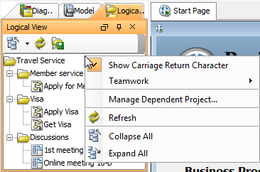

Popup menu
Popup menu of logical view
The pop-up menu of Logical View
Menu Title Description
Show Carriage Return Character
Display line breaks of multi-lined diagram name as carriage return character.
Teamwork
Perform teamwork activities.
Manage Dependent Project...
Add or remove dependent project.
Refresh
Refresh Logical View content.
Collapse All
Collapse all tree nodes.
Expand All
Expand all tree nodes.

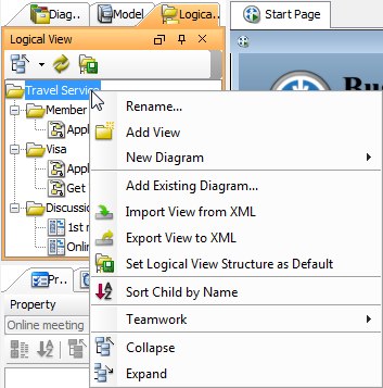

Popup menu of project
The pop-up menu of project node in Logical View
Rename...
Rename the project.
Add View
Add a view under project.
New Diagram
Create a diagram under root view.
Add Existing Diagram...
Add an existing diagram under root view.
Import View from XML
Import logical view configuration file.
Export View to XML
Export logical view as configuration file.
Set Logical View Structure as Default
Set the current view structure as default so that another project that will be created under the same workspace will share the same structure.
Sort Child by Name
Sort the views by name.
Teamwork
Collapse All
Collapse the project node.
Expand All Expand the project node.

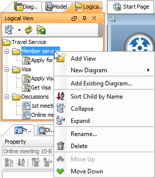

Popup menu of view
The pop-up menu of view in Logical View
Add View
Add a child view under the selected view.
New Diagram
Create a diagram under the selected view.
Add an existing diagram under the selected view.
Sort Child by Name
Sort the views/diagrams by name.
Collapse
Collapse the selected view node.
Expand
Expand the selected view node.
Rename...
Rename the selected view.
Delete
Delete the selected view.
Move Up
Move the selected view upwards.
Move Down
Move the selected view downwards.

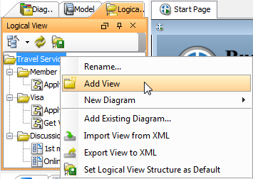

Create a new view node
Right-click a root node on Logical View and select Add View from the pop-up menu.
Click Add View from the pop-up menu
Enter the name for the new view node in the Input dialog box and then click OK button to confirm editing and close the dialog box. A new view node is, therefore, created under the chosen node.

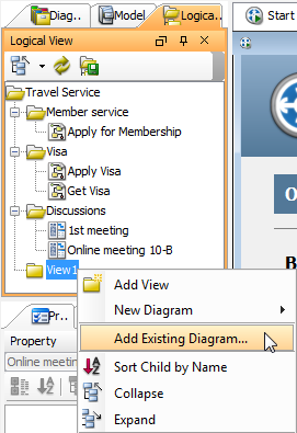

Add diagram to view
After you create a few diagrams, right-click on a view node and select Add Existing Diagram... from the pop-up menu.
Select Add Existing Diagram... from the pop-up menu

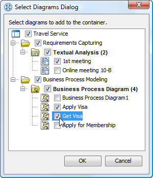

In Select Diagrams Dialog, check the diagrams you would like to insert in the view node.
Check diagrams in Select Diagrams Dialog
Click OK to confirm the selection.

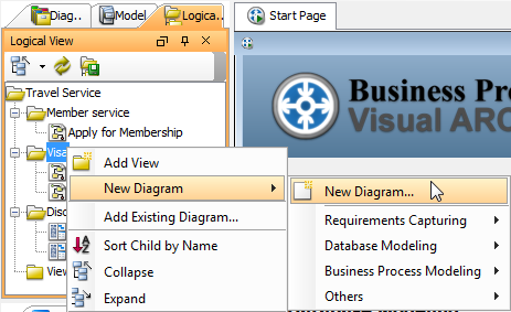

Create a new diagram
Right click the newly created view node, select New Diagram from the pop-up menu and select New Diagram... or a pre-defined diagram.
Select New Diagram... from the pop-up menu
A new diagram is, therefore, created under the view node.

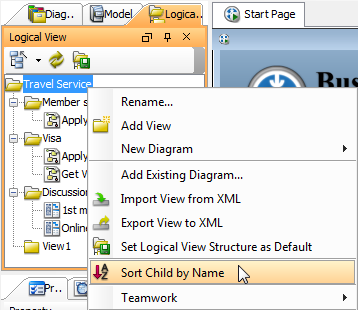

Sort diagram by name
In logical view, diagram are listed under diagram nodes by default. You can sort child diagrams by their names as well.
To sort by name, click Sort Child by Name button. The child diagrams will be listed by name, in alphabetical order.

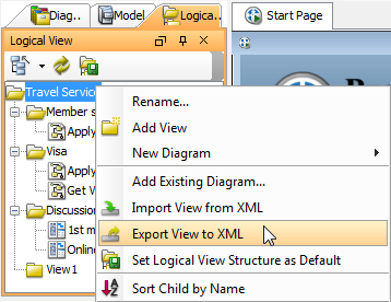

Export View Structure to XML
BP-VA allows you to export the current logical view structure as an XML file and to re-use it again on other projects.
Right click the root node and select Export View to XML from the pop-up menu.
Click Export View to XML from the pop-up menu
Find a location for exporting the project and enter its file name in Save dialog box. At last, click the Save.

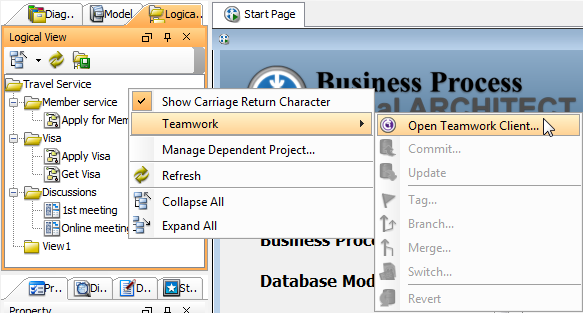

Connect to server for team collaboration
BP-VA's team collaboration support enables your team members work together on projects. To connect to server and perform related activities:
  1. Right click on the logical view's background.
  2. Select Teamwork and the action you want to perform from the pop-up menu.
