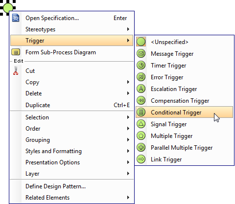

Defining a trigger
To define a trigger on an event, right click on the event and select Trigger, then the type of trigger from the popup menu.
To define a start event trigger
If you want to edit the properties of the trigger, such as the condition of a conditional trigger, right click on the event and select Open Specification... from the popup menu. Then, click on the ... button next to the drop down menu of Trigger to edit its properties in the popup dialog box.

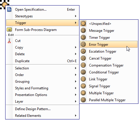

Defining a trigger
To define a intermediate event trigger

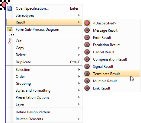

Defining a result
To define a result on an event, right click on the event and select Result, then the type of result from the popup menu.
To define an end event result
If you want to edit the properties of the result, such as the message produced by a message result, right click on the event and select Open Specification... from the popup menu. Then, click on the ... button next to the drop down menu of Result to edit its properties in the popup dialog box.
