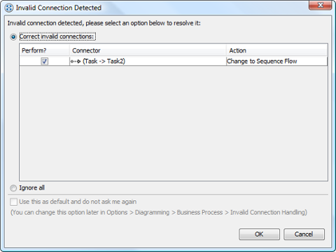

As mentioned before, you can use sequence flow to connect flow objects within a participant, and use message flow to connect flow objects in separate participants. If you attempt to use a type of flow incorrectly, like to connect flow objects within participant with message flow, you will be prompt to correct your flow.
Invalid connector is detected
There are several actions you can perform. First, you can correct your invalid flow by changing its type, like to change from message to sequence flow. If the connector should not be there, you may select to delete it. If you really want to keep the invalid connector, choose Ignore all at the bottom of dialog box. Click OK to confirm.
Possible actions of handling invalid connector - Correct it or delete it

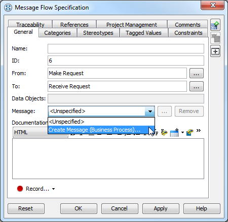

To do this:
  1. Right click on the message flow that you want to model its message, and select Open Specification... from the popup menu.
  2. Click on the drop down menu of Message and select Create Message (Business Process) from the popup menu.
    Create a message
    Create a message
  3. Name the message in the Message specification and click OK to confirm.
  4. You should see the message added appear in the drop down menu of Mesasge. Click OK to confirm the change and go back to diagram.

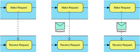

  5. Although the message is defined, you still need to visualize it. To visualize the message, right click on the diagram background and select Presentation Options > Message Flow Display Option > Show Message of Message Flow from the popup menu, then select the way of visualzing the message.
    Ways of showing message (from left to right) - Do Not Show, Associated with Message Flow, Overlapping Message Flow
