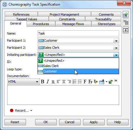

Setting participants and initiating participant
  1. Right click on the choreography task and select Open Specification... from the popup menu.
  2. In the specification dialog box, choose the pools for participant 1 and 2.
  3. Select the pool which starts the interaction from the drop down menu of Initiating participant.
    Selecting initiating pool
  4. Click OK to confirm editing and go back to diagram.

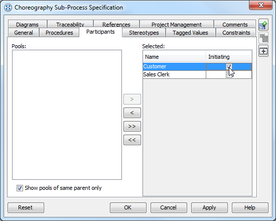

  1. Right click on the choreography sub-process and select Open Specification... from the popup menu.
  2. In the specification dialog box, open the Participants tab.
  3. Select the pools the choreography sub-process involve and click > to assign them.
  4. Check the initiating pool.
    Selecting initiating participant
  5. Click OK to confirm editing and go back to diagram.
