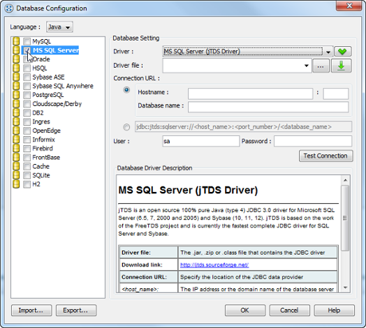

Selecting database
In the Database Configuration dialog box, check the target database.
Select database
Select database

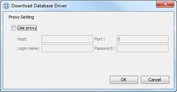

Configure proxy if required, click OK button to continue download.
Download JDBC proxy setting
