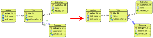

  1. Connectors can be joined at same point of a shape on the diagram. To do so, drag one end of a connector to the shape.
    Drag one end of a connector to a shape

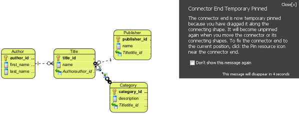

  2. The connector is temporarily pinned. A dialog box will be shown on the top right corner of diagram to instruct you how to pin the connector.
    Connector is temporarily pinned

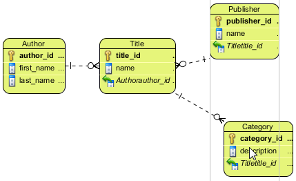

  3. Since the connector that links from shape and to shape together is temporarily pinned, either from shape or to shape is moved, the connector between them will be unpinned.
    Connector is unpinned
