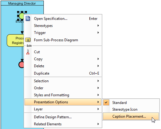

To set the position and angle of start, intermediate or end event, or gateway:
  1. Right click on the shape and select Presentation Options > Caption Placement... from the popup menu.
    To change caption placement

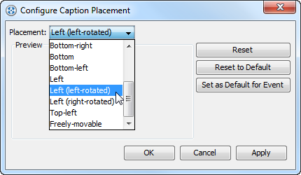

  2. Choose the placement, which is the position of caption. For some of the placement options, you can choose additionally the rotation of placement. You can preview the changes in the preview pane.
    To choose a placement option
