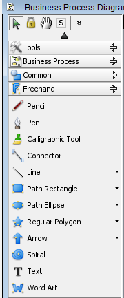

Freehand shape
Freehand shapes are multi-functional features in BP-VA. With freehand shapes, you can not only draw various kinds of shapes, but also insert an annotation. If you want to stress an important message with visual effect, you may use word art rather than using a note or a callout because you can reshape the text in word art, however, not in a note or a callout. Moreover, the shapes in freehand are flexible that you can twist them freely, but you can only resize a note or a callout.
Freehand toolbar interface
Summary of freehand shapes

NOTE: Freehand can be switched on by clicking on diagram toolbar and select Category > Freehand from the pop-up menu.

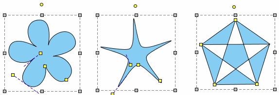

Drawing regular polygon
  1. Click on the diagram to create a regular polygon shape.
  2. You can modify the outline of shape by dragging the fine editor selectors in yellow.
    Other regular polygon outline

Drawing spiral
  1. Click on the diagram to create a spiral shape.
  2. You can reshape it by dragging the fine editing selectors in yellow.
    Other Spiral outline
