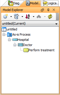

    The duplicated element can be found in Model Explorer, under current project.
    Duplicated element appear in model explorer
