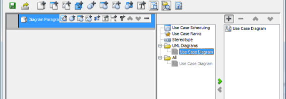

To loop specific type(s) of diagrams in project for listing their properties in paragraph form, create diagram paragraph at template root. To create diagram paragraph at template root:
  1. In the template editor, click on the  on toolbar.
  2. On the right hand side of the template editor, select the type of diagram(s) to loop and click  to confirm the selection.
    Select to loop use case diagram
