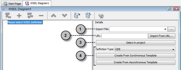

This creates an empty WSDL diagram. To continue, you need to select any of the four methods listed below to locate the source of WSDL definition.
Different ways to select the source of WSDL definition
Method Description
1 Import the WSDL definition from a .wsdl file.
2 Import the WSDL definition from a URL of wsdl.
3 Select the WSDL definition that exists in your project.
4 Create a new definition by first selecting the definition type. Apache ODE (Orchestration Director Engine) and Oracle are both supported by BP-VA.
Then, click on either to create from a synchronous or asynchronous template. Different template selection will give a different document structure.
Synchronous - Once a synchronous process is being invoked, its business operations had to be completed before the invoking process move on.
Asynchronous - Once an asynchronous process is being invoked, the invoking process proceed with the asynchronous process in parallel without waiting it to complete.
Ways to select the source of WSDL

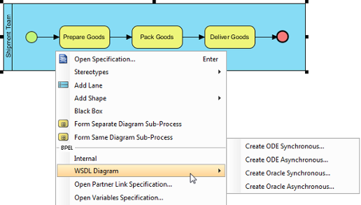

Alternative way to create WSDL diagram - from BPMN pool to WSDL
A process is the interactions between collaborators. Other than creating a WSDL diagram from diagram navigator, an alternative way is to create a from a pool (i.e. the collaborator) that initiate the process.
  1. Define the business process diagram of where the pool reside as BPEL diagram by right clicking on the background of diagram and selecting Diagram Type > BPEL from the popup menu. If you have done this before, ignore this step and move to step 2.
    Set diagram type to be BPEL
  2. Right click on the pool which initiate the process and select WSDL Diagram from the popup menu. Base on the type of process, and the type of workflow engine, select the appropriate option.
    Create WSDL diagram
    Create WSDL diagram
    Option Description
    Create ODE Synchronous
    Apache ODE (Orchestration Director Engine) is a kind of workflow engine supported by BP-VA. Select this option to create a WSDL diagram for a synchronous process that can be executed by ODE. Once a synchronous process is being invoked, its operations had to be completed before the invoking process move on.
    Create ODE Asynchronous
    Apache ODE (Orchestration Director Engine) is a kind of workflow engine supported by BP-VA. Select this option to create a WSDL diagram for an asynchronous process that can be executed by ODE. Once an asynchronous process is being invoked, the invoking process proceed with the asynchronous process in parallel without waiting it to complete.
    Create Oracle Synchronous
    Oracle workflow engine is a kind of workflow engine supported by BP-VA. Select this option to create a WSDL diagram for a synchronous process that can be executed by Oracle. Once a synchronous process is being invoked, its operations had to be completed before the invoking process move on.
    Create Oracle Asynchronous Apache ODE (Orchestration Director Engine) is a kind of workflow engine supported by BP-VA. Select this option to create a WSDL diagram for an asynchronous process that can be executed by Oracle. Once an asynchronous process is being invoked, the invoking process proceed with the asynchronous process in parallel without waiting it to complete.
    Description of options for creating WSDL diagram

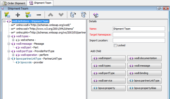

Starting from a blank WSDL document...
If you create a blank WSDL diagram (document) there are some points that you need to pay attention to in order to create an executable definition.
  1. Take Oracle Synchronous as an example. Once selected, a WSDL diagram will be created, with a tree on the left hand side listing the WSDL file structure, and the Details pane on the right, where you can edit the chosen node in tree.
    WSDL diagram is created

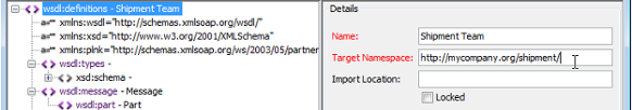

  2. Those fields labelled red in Details pane are fields that you must enter in order to export BPEL. One of them is the Target Namespace field of the root wsdl:definition node. Things that you will name in the WSDL definition (e.g. a message, portType) will automatically becomes part of the target namespace.
    Defining target namespace

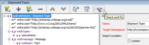

  4. At the end, click the button Check and Fix in toolbar, which helps you make appropriate changes to the WSDL definition in further (if you haven't done), such as to add property xmlns in wsdl:definitions element which refers to the target namespace specified.
    Check and fix
    Check and fix
