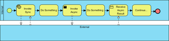

In BPEL, an invoke activity (i.e. an <invoke> element) is used by a process to invoke Web service provided by partner. An invocation can be either synchronous (request and response) or asynchronous (one-way). For a synchronous invocation, only one task is drew. For an asynchronous invocation, two tasks are drew, with one connecting to external pool and another connecting from external pool.
A sample BPD with tasks
