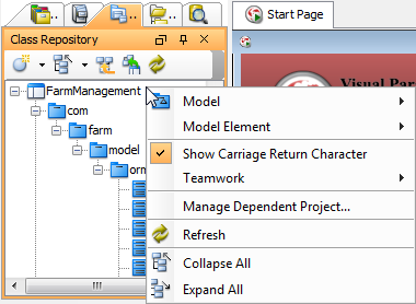

Pop-up menu
Pop-up menu of class repository
The pop-up menu of Class Repository
Menu Title Description
Model
Create a Model.
Model Element...
Create a new Model Element in Class Repository without the need of creating through diagramming.
Show Carriage Return Character
Display line breaks of multi-lined diagram name as carriage return character.
Teamwork
Perform teamwork activities.
Manage Dependent Project...
Add or remove dependent project.
Refresh
Refresh Class Repository content.
Collapse All
Collapse all tree nodes.
Expand All
Expand all tree nodes.

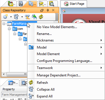

Popup menu of project
The pop-up menu of project node in Class Repository
No View Model Elements... It lists the model element(s) that either has not been visualized (no view) or has no master view.
Rename...
Rename the project.
Nicknames
Configure or switch to another nickname.
Model
Create a Model.
Model Element
Configure Programming Language...
Change to another programming language or configure the type mapping for a language.
Teamwork
Refresh
Refresh Class Repository.
Collapse All
Collapse the project node.
Expand All
Expand the project node.

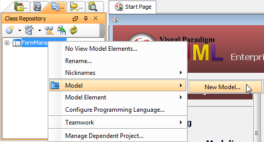

Creating a model
A model is a package like UML element that can store model elements and diagrams. Users are recommended to structure project by using model in order to maintain a clear structure for accessing project data and improve the application performance.
Right click on the project root node in Class Repository and select Model > New Model... from the pop-up menu.

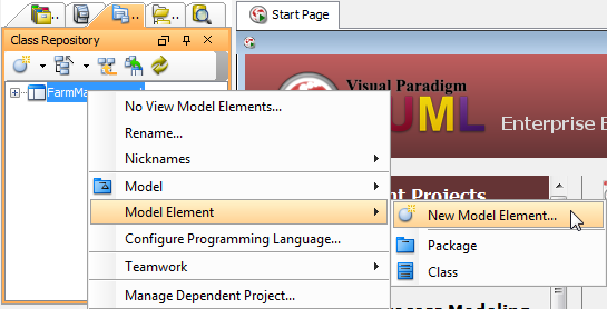

Creating a model element
A model element is created when you create a shape on a diagram. If you want to create a model element without visualizing it, you can create it through the Class Repository. To create a model element:
  1. Right click on the project root node.
  2. Select Model Element> New Model Element..., or select a pre-defined model element from the pop-up menu to create a new model.

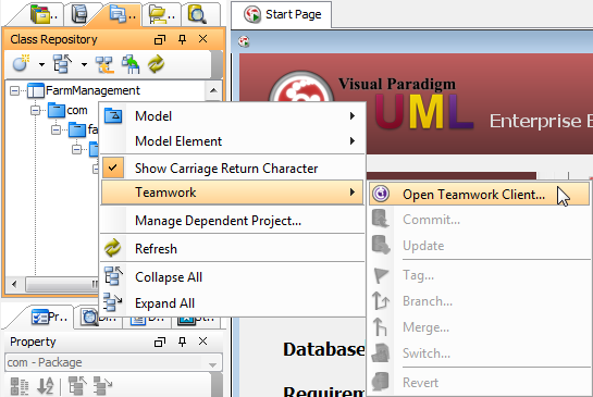

Connecting to server for team collaboration
VP-UML's team collaboration support enables your team members work together on projects. To connect to server and perform related activities:
  1. Right click on the Class Repository's background.
  2. Select Teamwork> Open Teamwork Client... from the pop-up menu.
