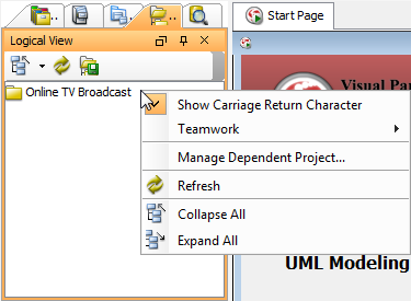

Pop-up menu
Pop-up menu of logical view
The pop-up menu of Logical View
Menu Title Description
Show Carriage Return Character
Display line breaks of multi-lined diagram name as carriage return character.
Teamwork
Perform teamwork activities.
Manage Dependent Project...
Add or remove dependent project.
Refresh
Refresh Logical View content.
Collapse All
Collapse all tree nodes.
Expand All
Expand all tree nodes.

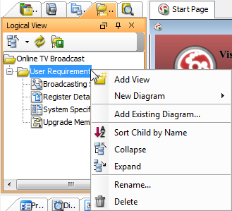

Sort Child by Name
Sort the views/diagrams by name.
Collapse
Collapse the selected view node.
Expand
Expand the selected view node.
Rename...
Rename the selected view.
Delete
Delete the selected view.

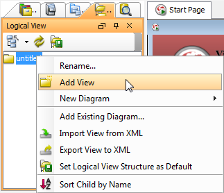

Creating a new view node
Right-click a root node on Logical View and select Add View from the pop-up menu.
Click Add View from the pop-up menu
You can enter the name for the new view node in the Input dialog box and then click OK button to confirm editing and close the dialog box.
A new view node is, therefore, created under the chosen node.

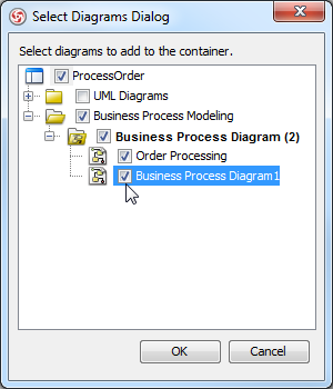

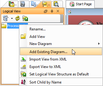

Adding diagram to view
After you create a few diagrams, right-click on a view node and select Add Existing Diagram... from the pop-up menu.
Select Add Existing Diagram... from the pop-up menu
In Select Diagrams Dialog, check the diagrams you would like to insert in the view node.
Check diagrams in Select Diagrams Dialog
Click OK button to confirm the selection.

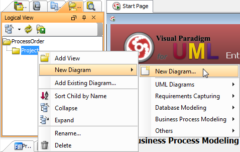

Creating a new diagram
Right click the newly created view node, select New Diagram from the pop-up menu and then select New Diagram... or a pre-defined diagram.
Select New Diagram... from the pop-up menu
A new diagram is, therefore, created under the view node.

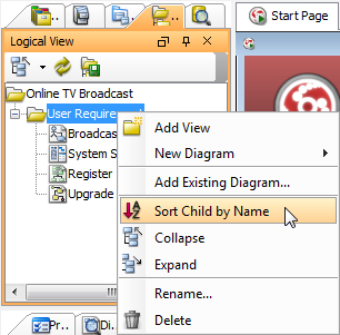

Sorting diagram by name
In logical view, diagram are listed under diagram nodes by default. You can sort child diagrams by their names as well.
To sort by name, right click on view node and select Sort Child by Name from the pop-up menu. The child diagrams will be listed by name, in alphabetical order.
Click Sort Child by Name

Showing/hiding carriage return character
If it is the case that the name of the diagram is in multi-line, the character ¶ will be revealed.
When Show Carriage Return Character is selected, line break will be shown.
To show carriage return character
When off, the character ¶ is hidden.
If you want to hide it, uncheck Show Carriage Return Character and the character will automatically be unshown.

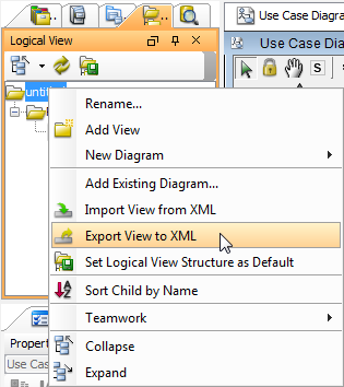

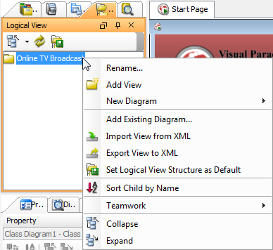

Exporting View Structure to XML
VP-UML allows you to export the current Logical View Structure as an XML file and to re-use it again on other projects.
Right click the root node and select Export View to XML from the pop-up menu.
Click Export View to XML from the pop-up menu
Find a location for exporting the project and enter its file name in Save dialog box. At last, click the Save.

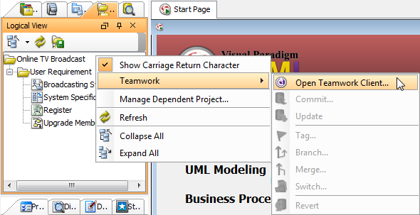

Connecting to server for team collaboration
VP-UML's team collaboration support enables your team members work together on projects. To connect to server and perform related activities:
  1. Right click on the logical view's background.
  2. Select Teamwork and the action you want to perform from the pop-up menu.
