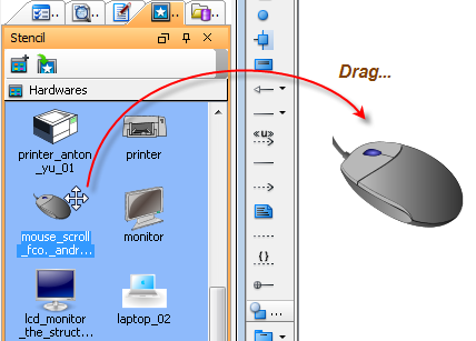

Click Add Stencil button on the top of stencil pane and select a subfolder from the pop-up menu.
Select Hardwares from the pop-up menu
When the subfolder is unfolded, press the preferred stencil and drag it on the diagram pane.
Drag a stencil on the diagram pane

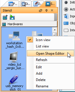

Editing a stencil
A stencil can be customized according to users' preference in Shape Editor.
Right click on the stencil pane's background and select Open Shape Editor from the pop-up menu.
Select Open Shape Editor from the pop-up menu
