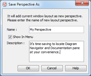

Saving your customized perspective
  1. In your current perspective, select View > Save Perspective as... from the main menu.
  2. In the Save Perspective As dialog box, enter name and description for the new perspective. Click OK button.
    Enter name and description

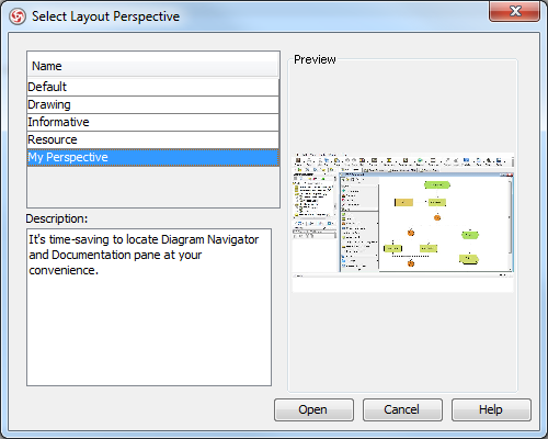

Opening a perspective
  1. Select View > Open Perspective > Others... from the main menu to open a perspective.
  2. Besides the pre-defined perspectives, your customized perspectives are listed in the Select Layout Perspective dialog box.
    The Select Layout Perspective dialog box
  3. Select a perspective under Name and click Open button.

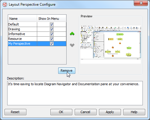

Removing perspective
You can remove your customized perspective or even the pre-defined perspective(s) in the Layout Perspective Configure dialog box.
  1. Select View > Manage Perspectives... from the main menu.
  2. In the pop-up Layout Perspective Configure dialog box, select a perspective you want to remove and then press Remove button. Click OK button to confirm.
    Remove a perspective
