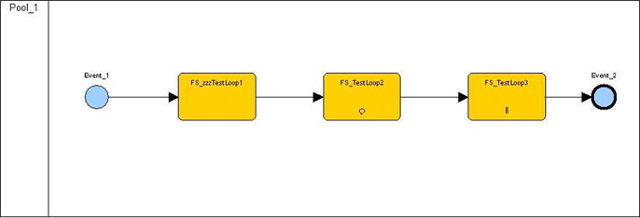

  1. Save your Telelogic System Architect drawing:
    A Telelogic System Architect drawing

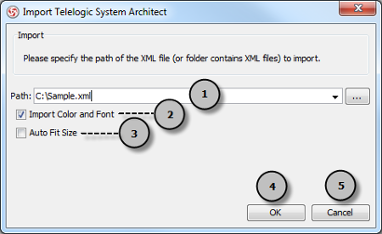

  3. Specify the file path of the Telelogic System Architect project.
    Specifying Telelogic System Architect path
    No. Name Description
    1 File path The path of Telelogic System Architect .xml file to be imported.
    2 Import Color and Font By selecting this option, colors and fonts of the shapes to be imported will remain unchanged. Otherwise, Visual Paradigm's default settings will be applied.
    3 Auto Fit Size By selecting this option, shapes' size will be optimized to their possible minimum size. Otherwise, the original size of the imported shapes will remain unchanged.
    4 OK Click OK to proceed with importing Telelogic System Architect.
    5 Cancel Click Cancel to discard importing XML.
    Description of Import Telelogic System Architect dialog box
