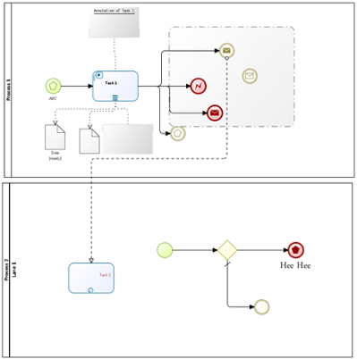

  1. Save your BizAgi drawing.
    A BizAgi drawing
    A BizAgi drawing

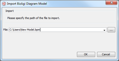

  3. Specify the file path of the BizAgi project.
    Specify BizAgi model path

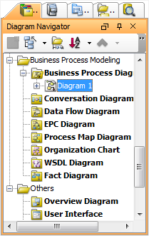

  6. The drawing can then be accessible in the Diagram Navigator. You can then double click on the diagram node to open the diagram.
    Diagram Navigator lists the imported diagram(s)

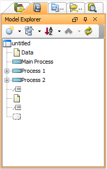

    Model element can be accessed in the Model Explorer. You can create diagram with them by dragging and dropping them onto diagrams.
    Model Explorer lists the imported model element(s)
