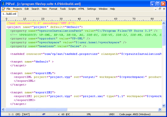

  3. Open the build file in any text editor. Modify the properties vpsuiteInstallationPath, vpproduct, vpworkspace and headless to suit your environment.
    To modify basic properties in build.xml

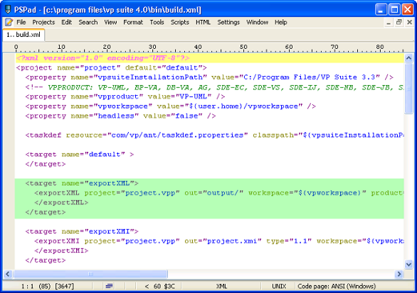

  4. Modify task(s) specific parts by changing the values of parameters. For details about the parameters, refer to previous sections.
    Modify task(s) specific properties in build.xml
