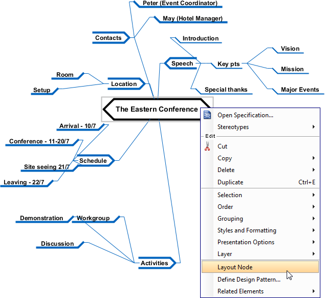

By performing a diagram based layout, all idea nodes in diagram are included in the range of layout. To perform a diagram based layout, right click on the central idea node and select Layout Node from the popup menu.
To layout nodes on a diagram

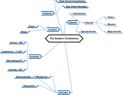

Result of diagram based layout - all nodes are layout-ed

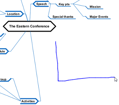

Mouse gesture enables you to layout shapes on a diagram through the movement of mouse. To perform a layout with mouse gesture, right press on the diagram background, sketch a "L" like gesture path and release the mouse button to execute layout.
Layout diagram with mouse gesture

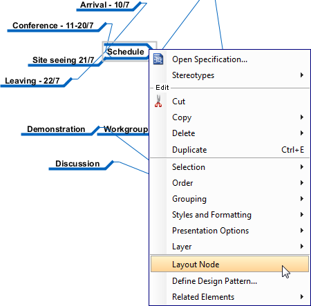

Node based
By performing a node based layout, only the chosen node and its descendant nodes are included in the range of layout. To perform a node based layout, right click on the idea node and select Layout Node from the popup menu.

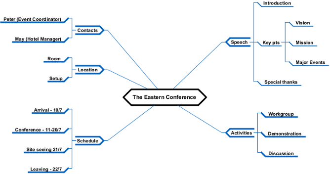

Result of node based layout - only Schedule node is layout-ed
