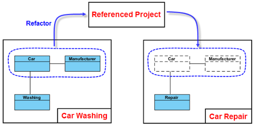

Refactoring is a technique of improving your modeling efficiency by allowing you to extract part of a project to a higher level of abstraction so that other (projects) can get the common part(s) included without the need of re-definition. Let's say, for example, you are modeling a vehicle maintenance company. You have created two projects for the distinct parts of the business - Car washing and car repair. When modeling car washing with class diagram, you have found that classes like Car and Manufacturer are also needed by the car repair model. You then refactor them to a referenced project so that the car repair model can link with it and have the classes included.
What is refactoring?
Refactoring not only reduce the time you need to spend by redefining same project data among projects. It also guarantees the correctness of model definition by enforcing common project data to be defined just once. This is also, in fact, the benefit of using project reference.

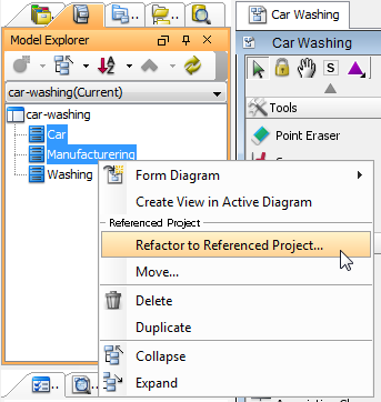

  2. Select and right click on the model elements you want to refactor to referenced project. Select Refactor to Referenced Project... from the popup menu.
    Refactor classes
    Refactor classes

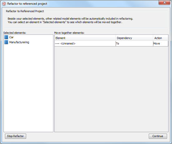

  5. Refactor not only moves the selected elements to referenced project, but also those related elements. Here are two examples:
    • Connectors that connect between the selected elements.
    • Class being selected as type of attribute of selected class.
    If such related elements exist, you will be listed with those elements. Check them. If you accept moving them to referenced project, click Continue at the bottom right corner to continue. Otherwise, click Stop Refactor at bottom left corner to terminate the refactoring.
    Elements to refactor (including those related elements)

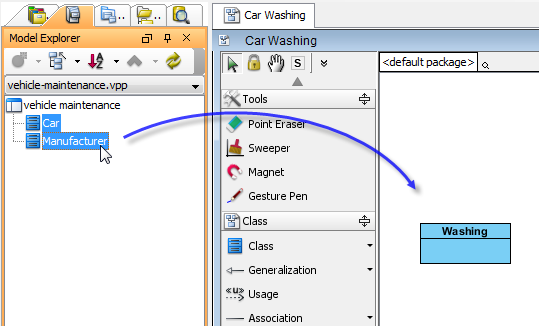

  6. Once the refactoring is complete, the project will reopen itself. From now on, you can access and use the refactored elements through the Model Explorer. Select the referenced project under the drop down menu. Drag to diagram the element(s) to use.
    To re-use referenced classes on current project
    Note that auxiliary views of refactored elements are now referencing the elements in referenced project.
