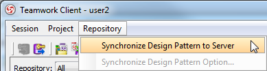

  3. In the Teamwork Client dialog box, select Repository > Synchronize Design Pattern to Server from the menu.

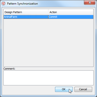

  4. In the Pattern Synchronization dialog box, verify your desired design pattern and action and click OK button to continue. The pattern will be committed to teamwork server.
    Commit pattern
    Commit pattern
    As a result, the pattern will be committed to teamwork server.

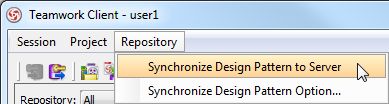

  1. After you open the Teamwork Client dialog box, select Repository > Synchronize Design Pattern to Server.

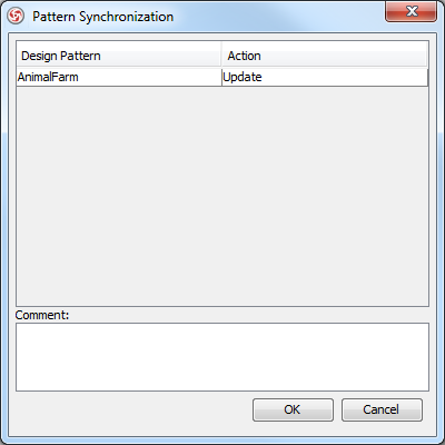

  2. When the Pattern Synchronization dialog box pops out, it displays that your pattern is available for update from teamwork server. Click OK button and the pattern will be updated from teamwork server to workspace.
    Update pattern
    Update pattern
