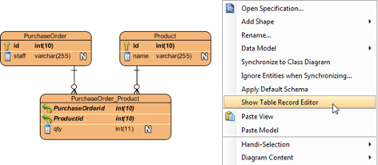

Default data has to be entered in the table record editor. To enable the editor, right click on the background of diagram and selecting Show Table Record Editor from the popup menu.
To show table record editor

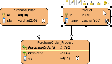

Then, select in diagram the entity you want to enter its default data.
Selecting entity
Selecting entity

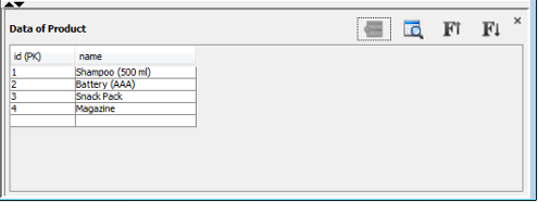

Enter the data in the editor. Double click on a cell to start editing. Click Enter to end editing.
Edited sample data
Edited sample data

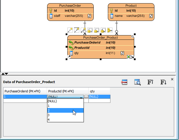

Selecting foreign key value
To select a foreign key value, click on the cell to popup the drop down menu, and select the value from the menu.
Selecting FK value
Selecting FK value
