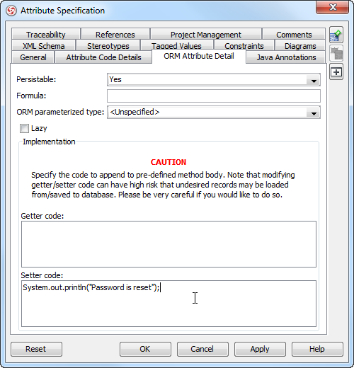

  2. Open the ORM Attribute Detail tab and enter the code body in Getter/Setter code sections.
    Customizing the setter of attribute
