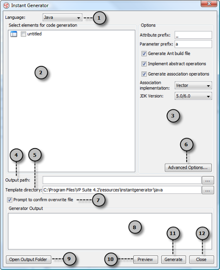

Overview of Instant Generator
Overview of instant generator dialog box
No. NameDescription
1 Language The programming language to generate.
2 Model element tree A list of packages and classes that can be selected for code generation. You must select classes for code generation.
3 General options Some of the common configurable options are shown here. You can configure them in advanced options.
4 Output path The folder where you want the code files to be generated.
5 Template directory Template governs how code will be generated from model to code. You can customize the template to suit your needs, such as to print company specific headers to each code file. If you want to use your own template, provide the template directory here. If you want to keep using the build in template, leave this option unchanged to let VP-UML generate with build in template. To learn more about customization, read the final chapter of this part.
6 Advanced options Click this button to configure any options related to code generation in a new dialog box.
7 Prompt to confirm overwrite file If a code file instant generator going to generate is already exist, by checking this option you will be asked whether to overwrite that file or not. If you uncheck this option, it will help you overwrite the existing file automatically.
8 Output pane Any warning, error or progress about generation will be printed here.
9 Open output folder Open the output path with system browser.
10 Preview Click to preview the code content. It is just a preview and code will not be generated to the output path by previewing.
11 Generate Click to start generation.
12 Close Click to close the instant generator.

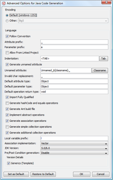

Generator options
On the Instant Generator dialog box you can configure some of the common code options at the right of dialog box. You can also configure the advanced options for more detailed settings by clicking the Advanced Options... button.
Advanced Options dialog box
Below is a description of available options.
Option Description
Encoding
The encoding of source file.
Follow Convention Whether to apply camel case Java naming convention.
Attribute prefix The text to append to attribute name as prefix.
Parameter prefix The text to append to parameter name as prefix.
Allow From Linked Project Check to generate also classes in referenced project.
Indentation Character(s) being used for indentation. Default is Tab.
Generate unnamed attribute
When two classes are associated, checking this option will generate attributes in both classes with each other as type. When unchecked, attributes will not be generated to both of them.
Unnamed attribute Pattern will be applied when generating name for those attribute without name.
Invalid char replacement Invalid char refers to characters that will result in a compile error when compiling code. This option is for replacing those invalid characters by given one.
Default attribute type Attribute type that will be used when attribute has no type specified.
Default parameter type Parameter type that will be used when parameter has no type specified.
Default operation return type Operation return type that will be used when operation has no return type specified.
Import Fully Qualified Whether to state in import statement the class to import, or use asterisk to present an import on all classes in a package.
Generate hashCode and equals operations Whether or not to generate hashCode() and equals() for each class.
Generate Ant build file Whether or not to generate Ant build file.
Implement abstract operations Whether or not to generate operations for implementing abstract operations defined in super class.
Generate association operations If you check this box, when a role is selected to provide setter/getter, the corresponding operation(s) will be generated for the role's attribute.
Generate simple collection operations
Whether or not to generate setter and getter for accessing attribute of associated class, when getter and setter are checked.
Generate additional collection operations
Whether or not to generate add, remove and to methods for accessing attribute of associated class, when getter and setter are checked.
Local variable prefix The characters to be appended to local variables.
Association implementation The type of collection to be used for association.
JDK Version Generate code in a specific standard of JDK.
Pre/Post Condition generation You can defined pre and post conditions in class, attribute and operation specification. Check this option to generate them as comment in code.
Generics (Template) Whether to generate template or not.
